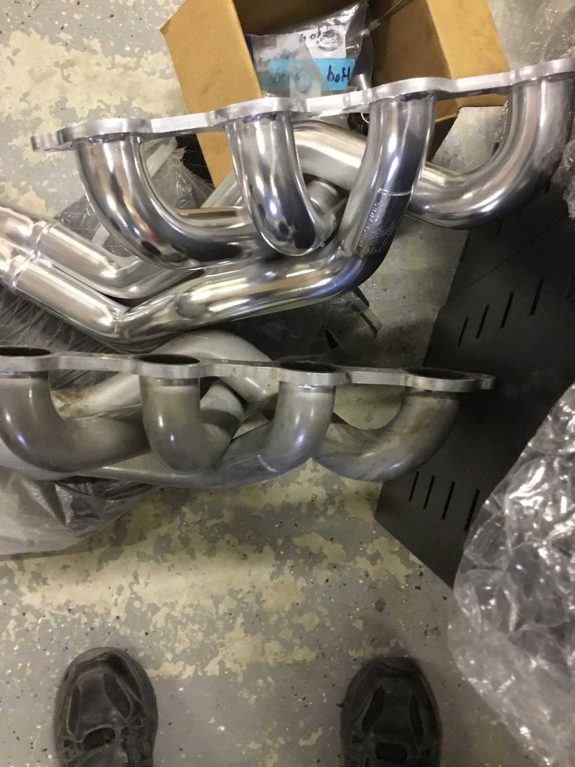

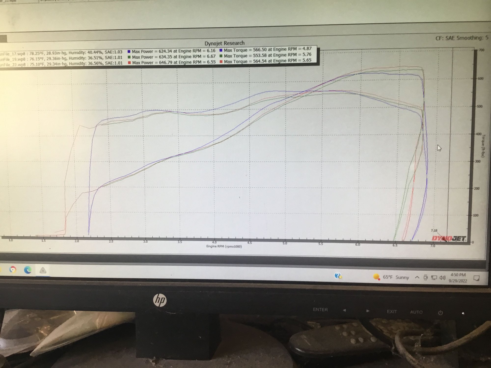

Finally got my car back to my tuner.i want to give a thumbs up to Kentucky Speed and Phil Smith (aka BlueCat) for a great job.
the blue line is from last year I was running a stock MSD intake and 1 7/8 headers on 93 octane /and dynomax muffler with 3” turn downs before the rear axles.
today we tried to tune it on E85 the car just did not like it.so this tune is on 93 octane.
with the changes I made I’m satisfied 2” headers and ported msd intake.I’m thinking that if I hadn’t installed 102 nitrous plate and 2 1/2 “ over the axle corsa sport exhaust system on the car .and kept 3” turn downs I would not have lost all that torque.

2 inch headers are best for like 418 or bigger. I would think them and the 2 1/2 reducers are definitely the causes of lost torque. Sorry but hope you get things squared away and do better.

2" headers are massive. The power difference between 1 3/4 and 1 7/8 on my 402 which made 660+hp was like 10hp at peak after some tuning. I can't imagine needing to step up to 2" headers. Surprisingly the 1 7/8 also had a better TQ curve and better low end.

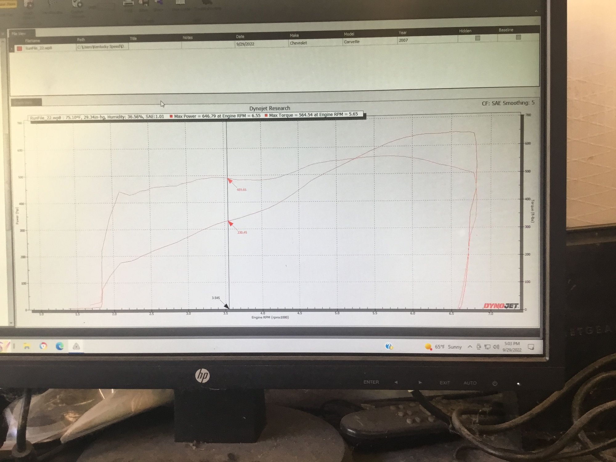

Great numbers and I think with the bigger muffler in the back, there was some more power there especially higher up. It looks like from graph and drawing line out you would still be at 635-640 hp and 480 tq at 7,000 rpm. So very little drop off in power from peak.
thank you for the kind words Lewis I can’t wait to see how your engine preforms.
I’m thinking that they will mirror each other.your right about the exhaust I know it’s holding me back about 20hp ,but it’s sure nice riding around without losing your hearing.
i know with 3” turndowns/electric water pump/and that 102 nitrous restricter plate out of the intake the car would put down 670hp to the rear wheels.
but with all the trouble I have had with lifters in the past year,I’m just going to drive it and enjoy. I know that the horsepower is there if I want it,and then there’s my nitrous bottle.

I agree, the headers are too big for your application.

you are probably right for the NA application.but when I turn the bottle on then it becomes a different story.thank you for your input.

Without knowing for sure what engine you are running (yes, I can see the GS labels blacked out but the engine could be anything), I will say this: at your power level, 2" are NOT too big. Most of those same people also think you need back pressure...no. Now, if you bump to bigger exhaust WITHOUT tuning, you will typically see it fall a bit flat but once you tune it, you virtually always pick up everywhere. If not, you got a bad tuner or have other issues that cropped up. People told me years ago that 1 7/8 were too bit for a stock LS1 but they were wrong - engine picked up hp and tq all across the band WHILE adding heavier rear wheels and tires. Plus, I was set for upgrades so when I threw in a cammed LS3, it was already good to go. This same principle will apply even more to rec/sq port heads. Tuned properly, it's hard to go too big because these engines love to breathe. You clearly did it just right.

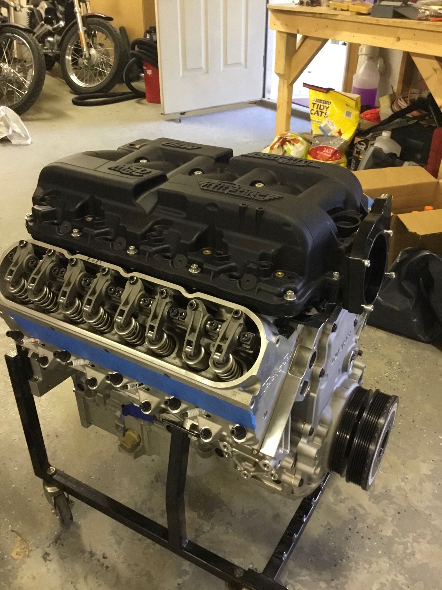

jimilz28 it’s a 450 cid RHS block /TFS 260 ls7 heads ported by Greg Good (2.250 intake/1.615 exhaust (286cc intake runner)
MSD intake ported by Greg Good
Cam Motion LLSR 255/269 114+4.5 intake 702/exhaust 683 /with stainless steel crower shaft system
Pac 1237x Valve spring setup for 750 lift /175 @seat 565 open/ setup .105 from coil bind
I’m with you about the 2” headers .if I would have left the 102 nitrous plate off and left my 3” turn downs on this car would have put down around 670 rwhp NA. and that’s thru 3.90s .that said if you look at the graph all it done was move the power band up 500 rpm. (the ported intake and 2” headers)
I have to say BlueCat done a great job on drivability for such a big cam.

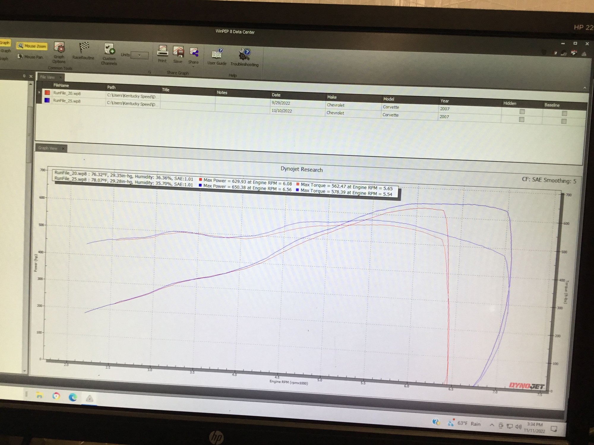

Went back and redyno my car yesterday with just the 3”x pipe and 3” turndowns.taking off 2 1/2 over the axle pipes and corsa sports . getting ready to take the car to the track I pull the muffler and passenger seat. I went ahead and had the tune checked ,he had to add a little fuel in the mid range . I got my mid range torque back.still on 93 octane

Good results and gives us an idea what the over the axle part can do for power at different rpms.

good results for the power bad results for the ears .double 06 I hope your project is going well best of luck

huge gains. do you run a dedicated fuel system for the nitrous? If not, i would try to get the E85 tune dialed in. Would pick up even more power on nitrous.
