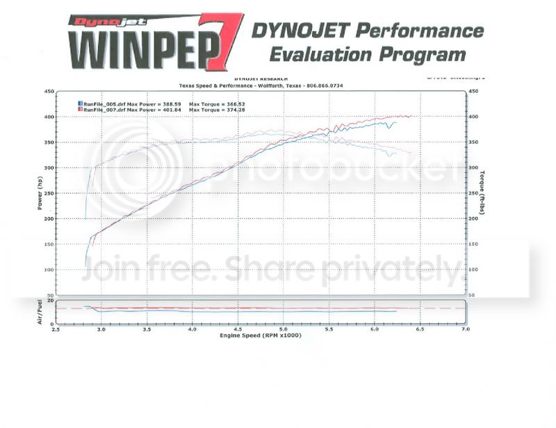

How does this graph look? Why in the world is it so wavey?
01' M6
232/236 .572"/.578" 112lsa
Pacesetter LT's w/ TSP true duals
lid
Normal?

Smoothing is probably at 0 or close to it. Smoothing is usually set at 5, however if that is at 5 somethings up. Once its smoothened out the peak numbers will be lower too.
