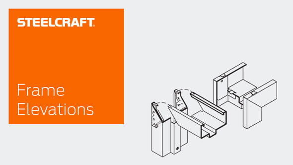

We only design the wall, type, mullion spacing, fastening and what type of glass it needs to be. The General Contractor will hire a sub who will submit shop drawings which we will either approve of note-up and then they will manufacture and install it.
I just draw a pretty picture and make sure that the client gets what they want and paid for.
If you go with a K.D. system you will need to call a commercial door guy as they will be the ones providing the frames and stops, some are standard sizes, but most can be manufactured to any size, shape and mullion spacing you want. Then a glassier will come in and install the glass. Sometimes the door guy can do both.
You can also specify a taller bottom shoe so that you don't have to build up a knee wall and protect the glass from foot impact but I don't see a 18" bottom rail so you would have to use tempered glass.
This is an image from Steelcraft's catalog, they are a K.D. frame and door manufacturer.
