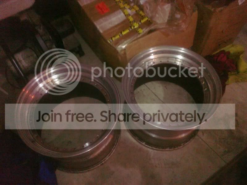

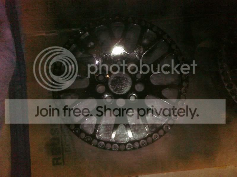

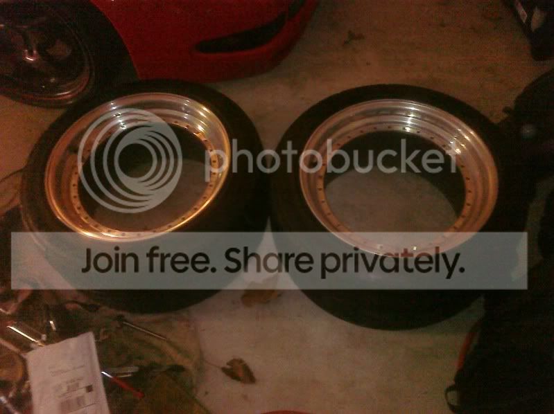

went with a different set of wheels and tires

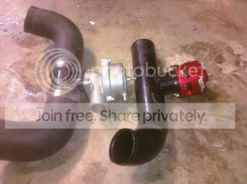

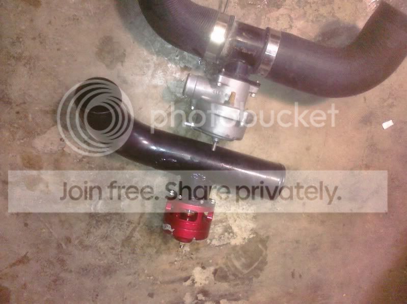

changed BPV
changed IAT sensor to a threaded style
changed the charge piping....

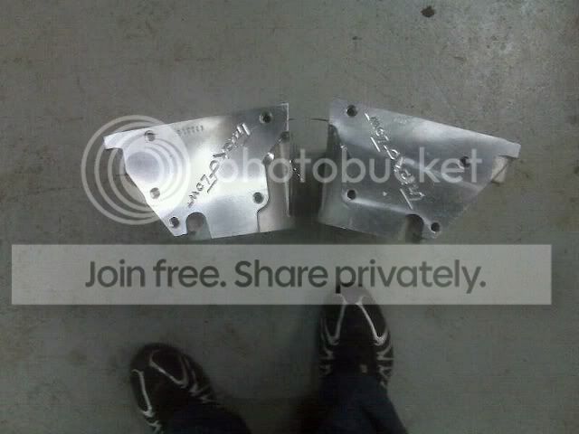

sooooo.... OUT WITH THE OLD IN WITH THE NEW
old
NEW

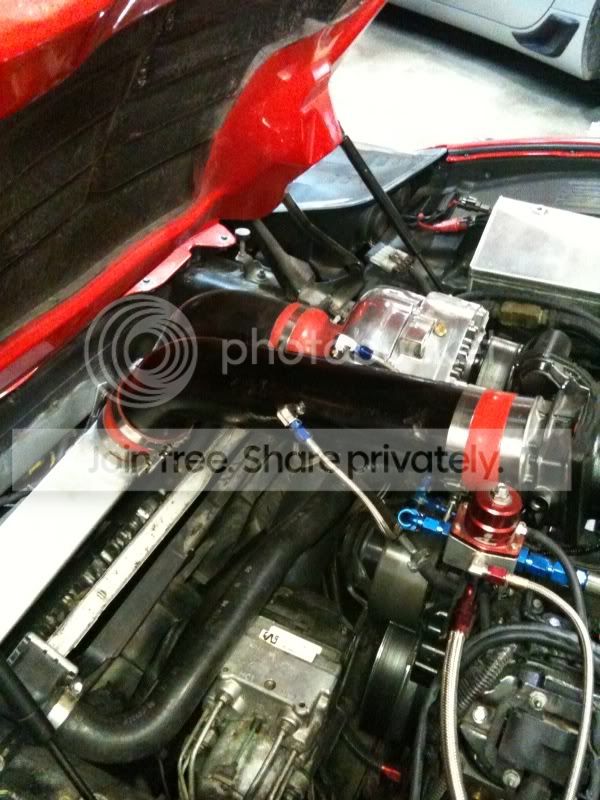

Keep a good eye on the plugs. We used that intake elbow on a project and lets just say I'll never run one again.It is rated for 400hp and causes the outside cylinder to run totally different than the inside cylinders.You can actually take header temp readings at idle and see it.
Other than that everything looks real good.
all the plugs seemed fine... it is rated at 400hp for na but boost changes alot. what would you recommend running?
I used the intakeelbows.com one and it looks a lot more open on the inside

Originally Posted by jason02Z
i run the elbow on my car but i cat that flap thing out of it thinking that was the problem with slowhawks car..it seems to work on turbo set up
It's working but not right.Your car had to be tuned on certain cylinders.This is why it's lasting so long.A reguler tune would of killed the motor already.
A sheetmetal like intake elbows .com.
When you get a chance take the header temps at idle.Our's were 100 degree's colder on 1,2,7,8. On a built NA car it was a 100rwhp difference.It tuned in fine but was low on power.

Here is a pic of the elbow on a 97 Vette built like yours.
that's the money maker! I love that elbow, it compliments the set up AND serves a function

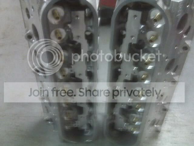

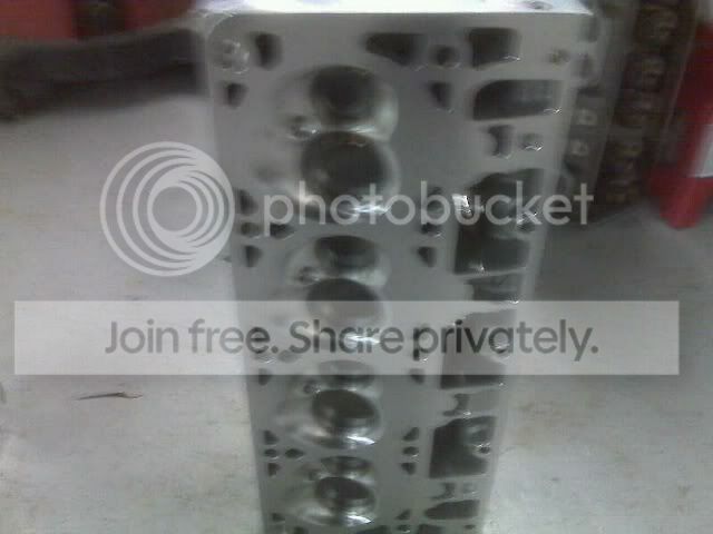

switch to TFS heads
droped compression to 9:1 from 9:8:1

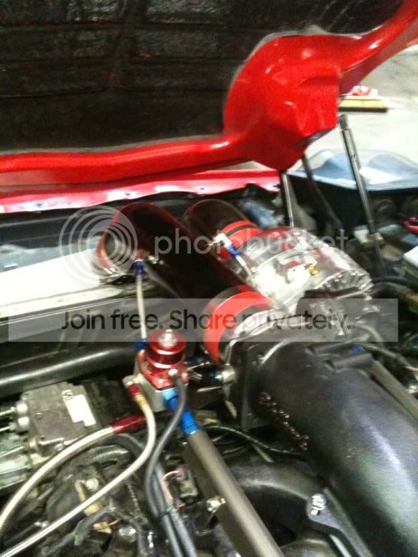

switch BPV to Big Red procharger

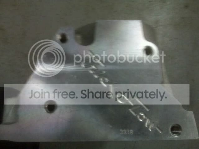

switched elbow to sheet-metal one (a lot more plenum volume)
adding wastegate and electronic boost controller.

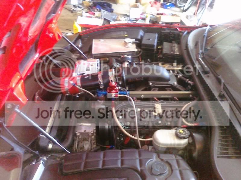

the new hotness has arrived

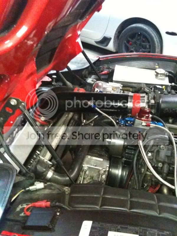

pretty much done... just fixing some exhaust issues..
bad pics but ya get the idea...
new ARH 1 7/8 headers

Car is finished
some more pics and dyno video will be added soon
had a problem with the new elbow making the TB hit the fitting soooo had to change it up some
