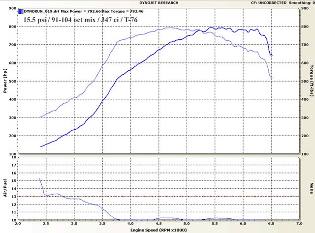

Here is NicD's 347 on 15.5lbs of boost with a 76GTS. This turbo will get you mid to low 9's depending on your setup and is good for 800-900 rwhp through a manual. The ST80 will get you low 9's to high 8's if you have a well dialed setup. DrTurbo said the ST80 is 10" tall.
PT76GTS = 105 - 110 lbs/min ??
ST80 = 121 lbs / min
PT-88 = Around 120lbs
10.86 x lbs/min of air = hp
