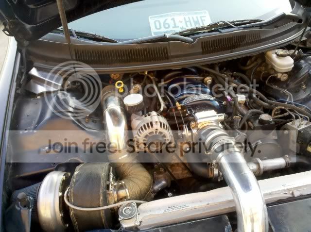

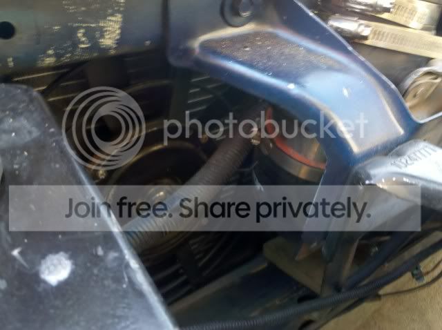

How about some pictures of the fan set up , The close radiator hose,,

Old Sep 11, 2011 | 02:12 PM
forgedlt4's Avatar
Posts: 326
you shouldnt have any issues. mine is WAY closer.

Def. try burping it again. put a hyrdolic jack under fthe front end and jack it up so the rad cap is higher than the engine a few inches, this will help the air that may be in the system travel up and out of the rad. cap.
With the rad cap off and the defroster/heater on full heat and high fan setting. Start the car and let it run it may spew coolant a couple times while it is pushing the air out of the system.
But let the system cycle the thermostat a few times, a 185* t-stat should be better, becuase it alows the coolant to stay in the radiator longer and cool down so while you are burping your system try running a fan infront of your radiator, to simulate driving.
Also do you have a Front mound intercooler? If so it could be blocking airflow to the radiator not allowing the coolant in the core to cool down before being cycled cack into the engine.
Second, I have not seen pics of your car so how is the availibility of airflow to your Radiator, do you have any extra vent tubes made to direct airflow to your radiator. being that you are turbo charged, that turbo will create a lot of heat under your hood.
That being said you will need as much cooling as possible. I have cooling issues with my Eclipse turbo right now, so I feel your pain.
I know most of this was said in earlier post but there was not a lot of explination detail in most of the post. Hope you get it fixed man that is quite a large turbo you have under the hood there lol.
