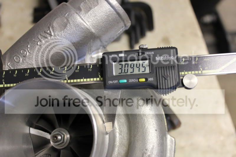

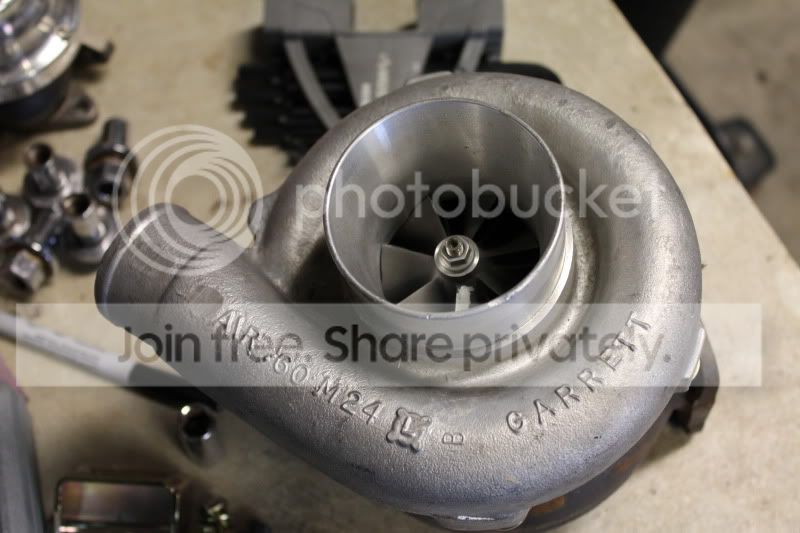

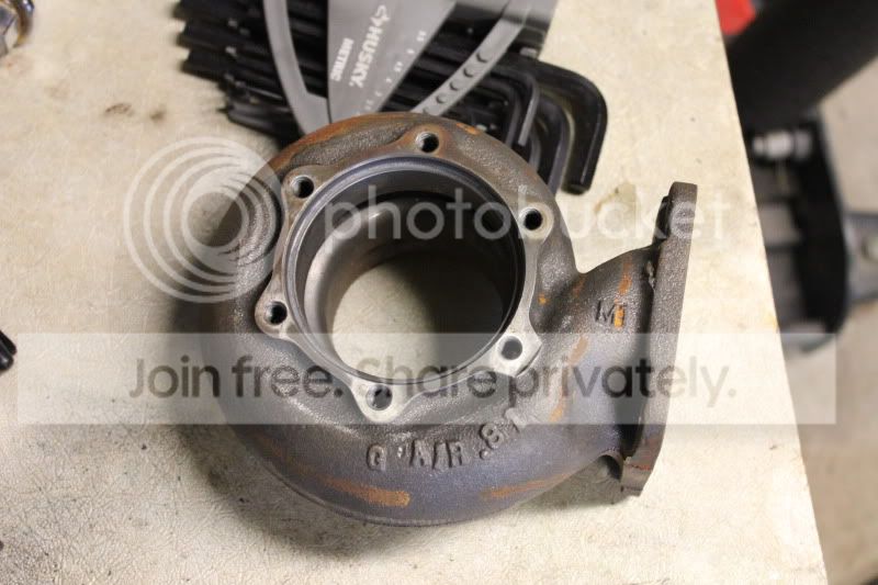

I've had this Turbo for 4 years and a local guy offered me $350 for it but he wanted to know specifically what Turbo it was. Never used and I lost the paperwork when I ordered it. So I measured everything and took pictures
Compressor = 57.7 Inducer 76.1 Exducer Calc'd Trim = 58
Turbine = 73.5 Inducer 64.17 Exducer Calc'd Trim = 76
Any help would be appreciated.
Here's some pictures:

Is he wanting a specific name for it? I think you pretty much have all the important information, it's a garret turbo with 58mm compressor wheel with E-cover, 65mm turbine wheel (probably a P-trim wheel) with a t4 .81a/r on-center exhaust housing.

Not a tag on it anywhere I'm assuming? Only way to know for sure would be take it to a turbo shop and let them measure everything to find the trims and such.

Well this is one of those Turbos thats hybrid together. When a turbo builder does that they remove the tag since its not accurate anymore.
As I remember it this one was built to flow some good numbers but for the life of me I don't remember what HP it topped out at.
