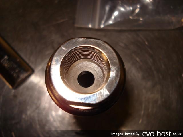

Is anyone using their filter between the turbos and pump ?
All the pump and filter fittings are 3/8" NPT, fairly large.
However the outlet side...ie pump/suction side is incredibly small ID.
ie, it drops down to barely over 1/4" inside.
Will this still yield adequate flow to scavenge two oil journal turbos which require a fair amount of oil ?
Turbowerx say it is fine, just seems odd to me, especially on the suction side of the pump ?
