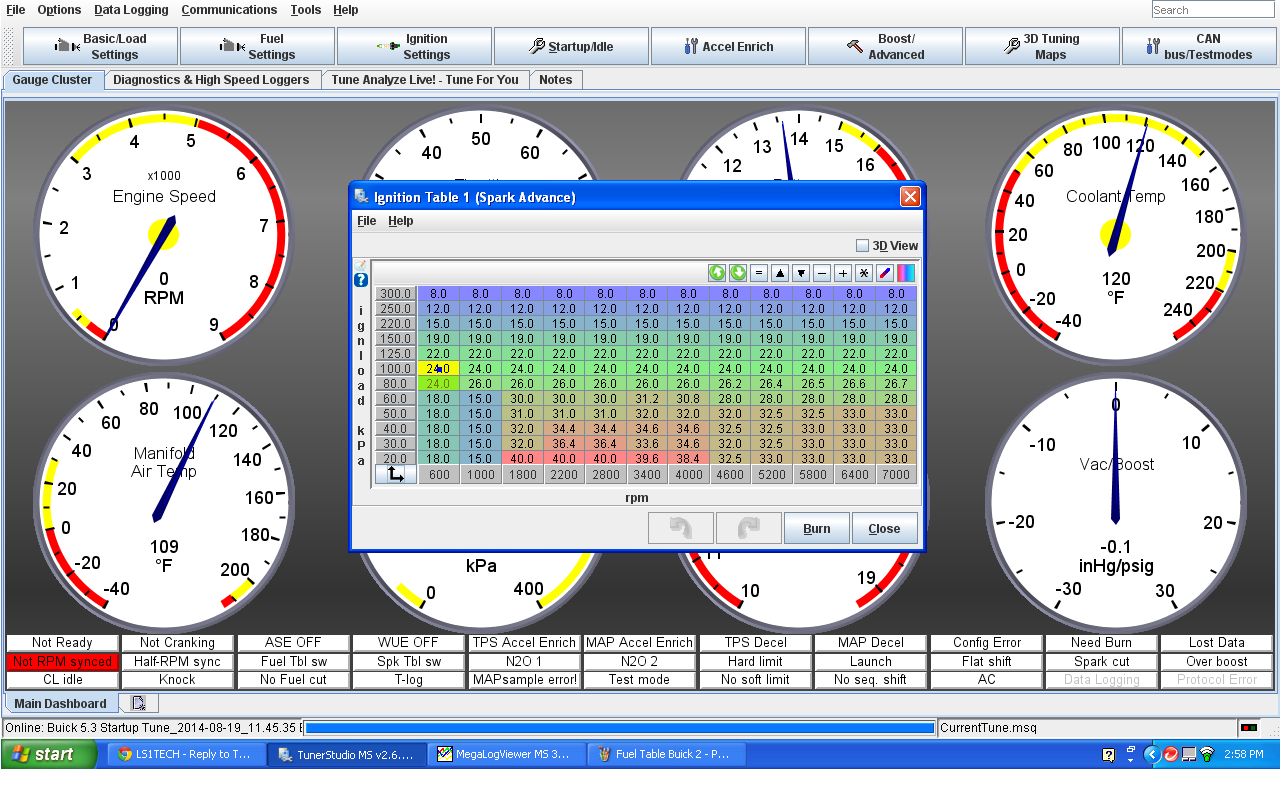

Default Fuel and Timing Tables
Hoe this is what you are looking for.
File Type: bmp
File Type: bmp
