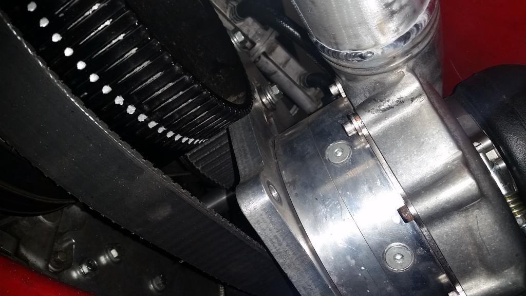

I am working on a car with a F1D mounted on a SchoneckComposites bracket cog kit as seen here: http://www.yellowbullet.com/forum/sh...d.php?t=372769
What combination pulleys is anyone with this setup running? Right now this car has 83/42 pulleys and the crank pulley was so close to the main plate that bolts to the front of the block that it rubbed under boost, and after the plate was clearanced the crank pulley rubbed the idler pulley as you can see in the pics. The shoulders on the idler pulley have now been turned down to clear. I believe its the crank/pulley flexing and not the bracket moving. Also how tight do you run the cogged belt? This was so tight it took 2 full turns of the tensioner bolt just to slack the belt 1/16.

Probably should move down on the crank pulley. Also the belt doesn't need to be that tight. I get mine to where I can just barely twist it 90* and call it good. Never had a problem.

Thanks, the belt is definitely going back on looser. I have a lot of experience with 671/871 blowers and run those belts with almost a full inch of slack when cold, but when the motor heats up it will take all the slack out of the belt. The rear gear is being changed today, and will reassemble everything else and going to be re-tuned tomorrow. Will have to see where we are with the rpm after that, right now shifting at 6500 the blower is sinning at 70,200 and the car doesn't pull hard after 5500.

Crank too bracket clearance is tight but i pull the belt toward the pass side and have just enough room to slide it off the pulley. I don't have to take any pulleys off to change belts.
