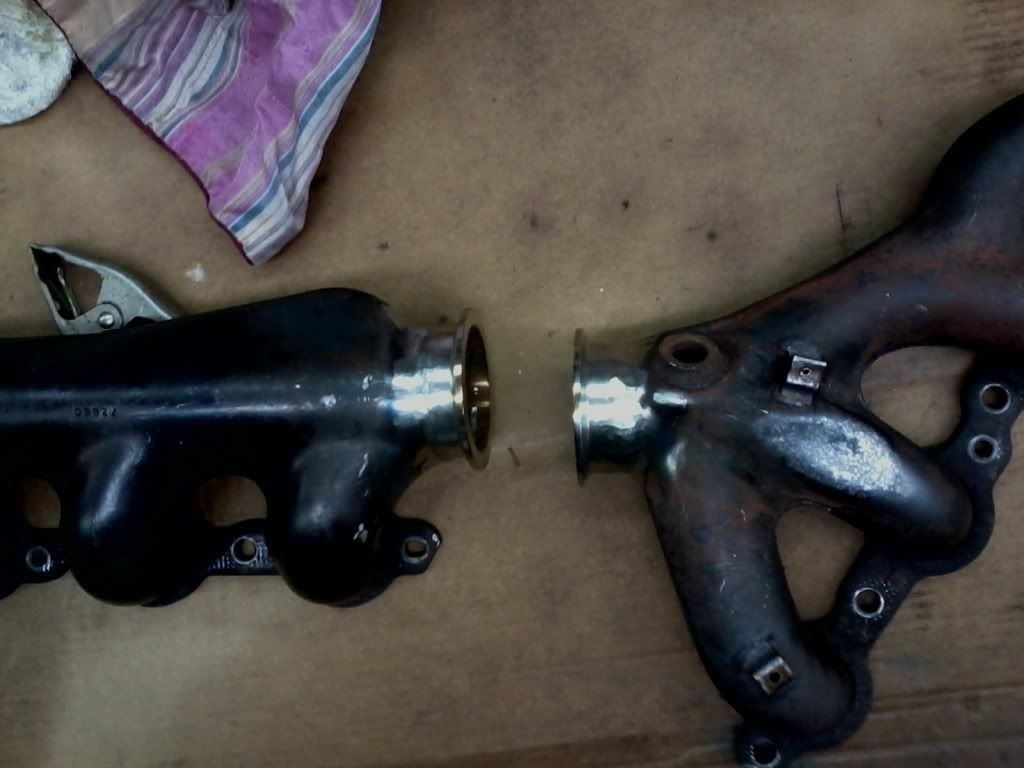

FWIW most go forward facing and down. Allows for a cleaner install and factory mounted coils and wires.
Some of the corvette manifolds are stamped SS. My 98 Fbody manifolds are also stamped SS. Originally I set them upside down and forward facing. Was a hassle with the wires and coils IMO. I've since run a truck manifold downward and forward facing and I like it much better.
98 Fbody manifolds...
New truck manifolds

Thanks for the info. I can see how the plug wires and dipstic will be a hassle with them upside down. I think I need to get some Vbands on them before I go further because it will give more mounting options instead of the flanges.
When You guys mount these to the block what are you using to seal them? I have a bad streak of header leaks and I don't feel like dealing with that. Do these seem to seal well?
'95 wannabe, Those could be an option. Do you know what size the Vband is?
