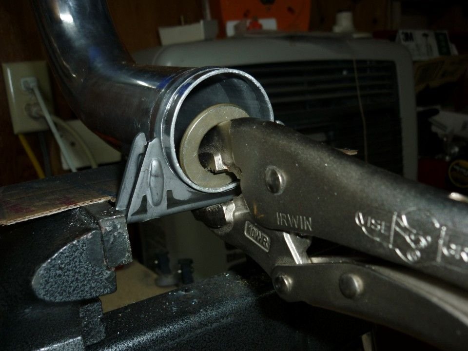

Funny no bead rolls on the ends. Blue tape and a hacksaw is your best friend. I also made similar to this tool to bead roll the ends. Just tack weld it onto your vise grips

If that home-made bead roller tool works in the pic above, then it is worth it, I just paid $248 for tig welding my intercooler pipes together and some of them already had bead rolled ends. Had to cut some pipes up to get them where I needed them.
Around $95/hr for tig welding aluminum, so if you can't make a bead roller tool, put it in your go-fast budget.
