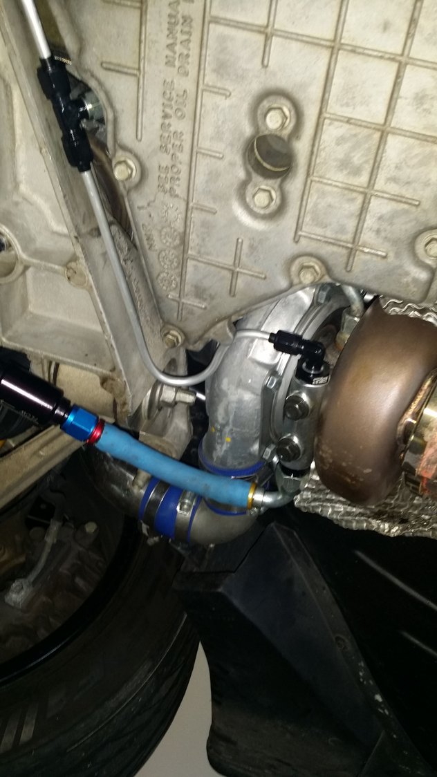

Like I mentioned in an earlier post, I didn't intend on this being a production piece but I can certainly build another set for someone that is looking for something better than the APS turbos. I have been running these for a few months now and they are working great. They have a handful of 25-minute road course sessions on them along with 1000 miles of street driving and have had no issues whatsoever. I also made some low profile vented turbo drain fittings that gave me some better ground clearance (pictured).
