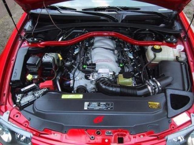

2004 GTO

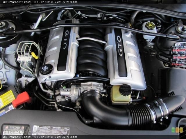

2005 GTO
Engine compartment packaging is different between the 2004 and the 2005-06.
We didn't feel the Corvette bracket would work on the CTS-V, and we had used the GTO bracket on other conversions and liked the way it worked out. We use a hybrid balancer and space out the power steering by 3/16". Thanks. Bob
