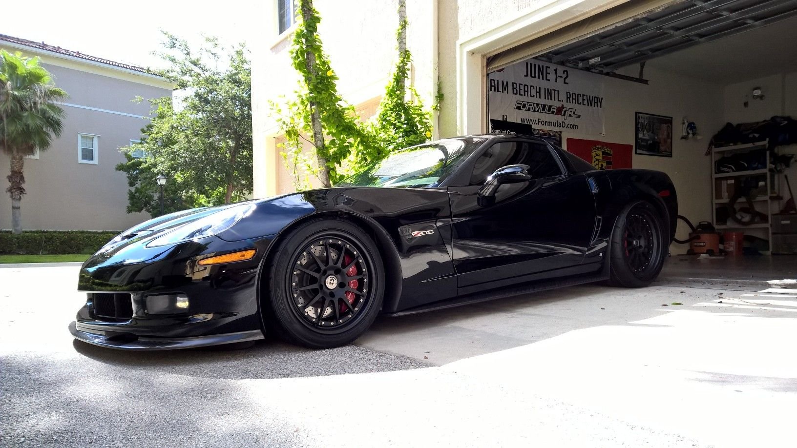

Matte black wheels look way better. I'm interested in your thoughts m the LG coilovers once you try them out.

thanks....most are liking the matte black wheels, esp if I wrap the car matte white. eager to mount them either way.
i will definitely let you know re: the Lg's - I have heard good things, and expect to like them - a lot.

Getting close! and both of the HRE's look awesome. I think I'd go with the 540's.

Awesome build, and I also vote for the matte black wheels
