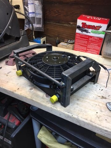

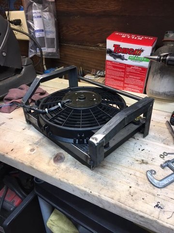

I fabbed up this cooler/fan setup last weekend for my oil system to go underneath the passenger seat.
Unfortunately I don't have any data to support what my oil temps are other than the pressure drop I experience when I'm hammering on it or when to ambient temp. is high.
I'll be curious so see if this helps since it will be on a 180 degree thermostatic switch as well as manual switch to cool the oil off before shutting down the car.
The car is down for the winter and I had this laying around but I also feel like this will help extend my oil life and it can't hurt right?
Interesting idea for location. I take it this is a track-only car?
I had considered adding a small temp-activated fan on top of my cooler but decided against it.
Actually this is a street oriented car and actually didn't see a track this year.
I drive the hell out of it though, I went on a 400 mile trip this summer with it plus beating on it around town.
I'm of the frame of mind that the turbo HAS to be adding heat to the oil, I don't see how it couldn't and as such an oil cooler could only help extend oil life and keep my pressure stable in all conditions.
We will find out either way.

I'd have two concerns over having the cooler inside the passenger compartment for a street-driven car:
1) Oil leaks and
2) Where is the heat going? AC is on my to-do list as soon as I can afford to get it fixed, I wouldn't want even more heat.
I agree the turbo will add heat so a cooler is a good idea.
1) Oil leaks and
Sorry, bad description.
It's underneath the car underneath the passenger floor board.
There's a large hump in the floor where the catalytic converter used to reside where its mounted.
I'll get photo's of it when it's complete.
From the research I've done oil temp needs to reach 180' to burn off any condensation in the oil, that and the Setrab temp. switches I found were offered in 160' and 180' temps so I'm thinking that's correct.
I opted for the 180' switch plus a manual switch so I can cool the oil down after a beating before shutting the car down.
I should have the car fired up this weekend so we'll see how it turns out.

Here is a pic of the cooler installed in the car.
It's mounted right under the passenger floor board with a bracket I made.
I didn't get it wired up yet but I test fired it and there are no leaks which is always a plus.
I'm gonna have to wait until summer to test it out unfortunately so look for this post to be raised from the dead in 10 months lol.
