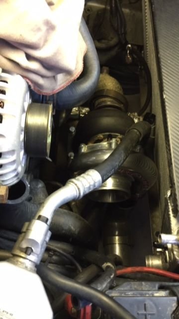

I just replaced a TC78 (7868 .96ar) with a T7875 (1.15ar). I had to remove the AC condenser and slide the radiator back to get it to fit. It's still the stock radiator and two pusher fans and so far it's staying cool. I only have about 1/2" of clearance between the turbo and the radiator (PTS/PTK/ebay kit). The spring that used to make between 7 and 9 psi on the TC78 only makes between 3 and 5 on the T7875.

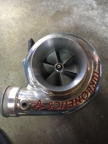

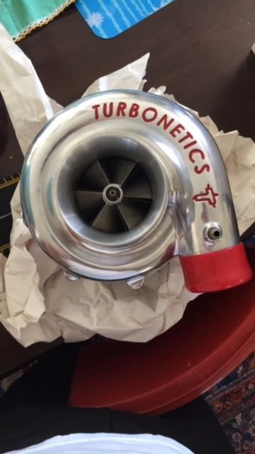

I'm necro posting I know lol. I finally got a cutout installed which really helped the top end pull but I'm still hitting a wall at about 5800 rpm. The car definitely likes to party with the cutout open but I came across a deal on a almost new T7875 that I just couldn't pass up lol. So the TC7868 is gone and now I'm making room for the bigger T7875 which I think will work better with my stage 3 cnc ported 317's and big turbo cam. Here's a couple photos of the units so you can get an idea of the size difference which isn't huge but will require some modification.
T7875
TC7868

Can you get a side by side picture of the two? I figured the only size difference would be the larger exhaust housing.

Sorry Stover, one unit was going and the other showed up so I couldn't photograph them together. The turbine housings are the same size and in fact the .96 is slightly smaller than the 1.15 in circumference other than that no change there.
The compressor housing is noticeably bigger though. from the turbine shaft to the outside edge that would next to the radiator its about 3/4" bigger so I'm gonna have to move some stuff around. I have a few ideas so I'll keep you posted on those and overall driving feel.

So the T7875 is in! It was a little bit of a pita to be honest lol. One of the T4 flange bolts is right under the bolt for clocking the housing and getting a bolt in there when using the Huron Speed hot side requires some creative engineering but it works. I was able to keep the AC but had to lose the washer bottle since I moved the bottom of the radiator forward about 1" to clear the T78 compressor housing but it worked great. I had to notch the top core support pretty heavily to make room for moving the radiator but all in all it looks good. A quick test drive revealed that the spool is almost as fast as the TC78 but the power up top is far better. Couple that with a turbine whine that's loud AF and its a win win for sure. I now have traction issues at the top of third which is awesome. Hopefully I will have the tune dialed in within the next few weeks in which I will report back. Cheers!
