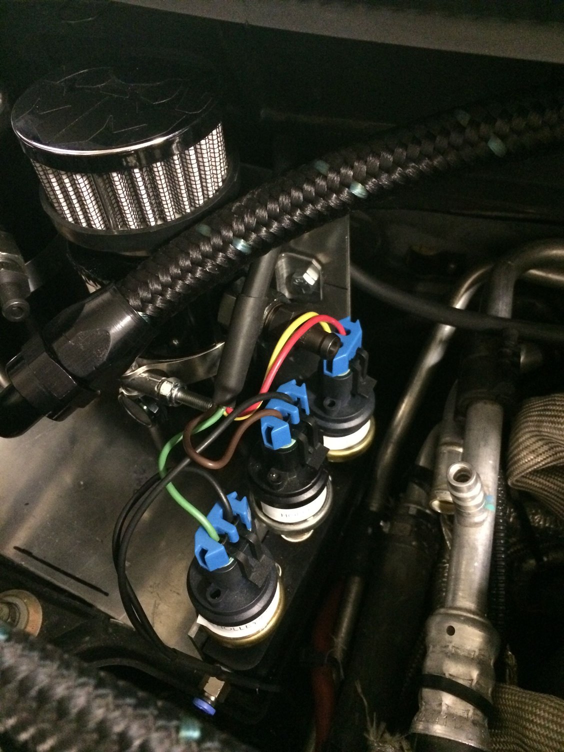

I use the racetronix hobbs switches which are adjustable a few lbs either way of the rating. This way I can fine tune exactly where my pumps kick in. They are mounted side by side so that if one switch or pump would fail, I can always keep at least one running, just by switching over the connection.
