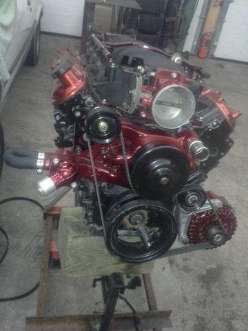

i currently have a 5.3 swapped bmw. looking into an lsa blower.
specs are torqer v2 cam, push rods/valve springs. stock heads and gaskets.
2014 camaro 6.2 waterpump.
ls1 intake.
first question is the belt alignment. stock 6.2 waterpump lines up perfect with truck accessory. will the blower line with with that? I seen some running with a second belt. i cant do that do to space to the rad. so what do i need to make it run off the one belt?
i know i need the adapters to the heads.
will my vette reg/filter work with the new fuel rails?
will ls1 injectors fit it? will they feed the blown 5.3 or do i need bigger?
any other info would be a great help.
here is a pic of what i have now
