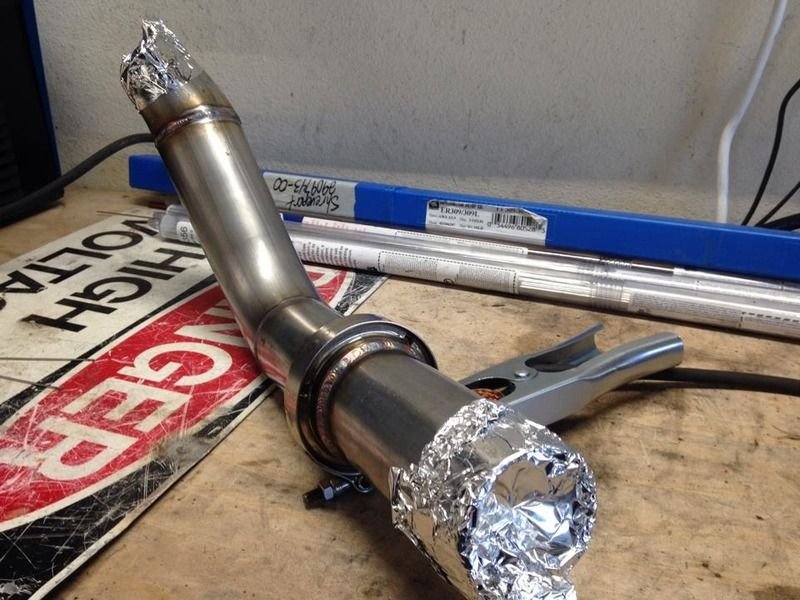

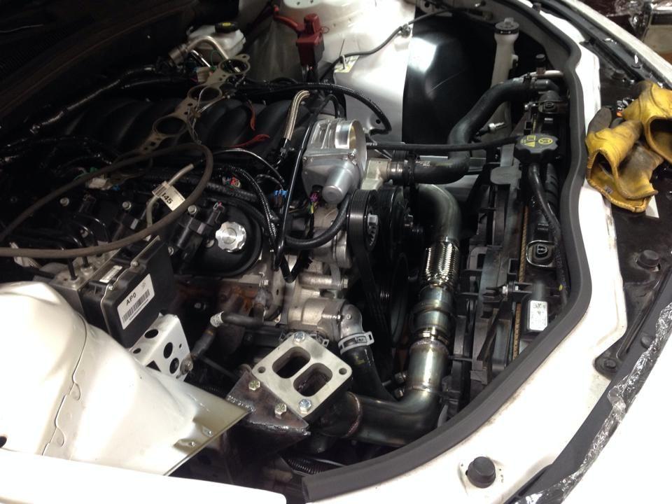

Goal of the car is to make some decent power on a full one off single turbo setup. All fabwork is being done by local fabricator here in Shreveport called T.I.TS. Car will keep ABS, AC, Power Steering and all other factory options. Very basic setup: S475, 4 inch downpipe, precision 66mm wastegate and 2.5in dump tube, 4 inch thick intercooler, 3.5 inch intercooler piping. Kit will be fully ceramic coated. Push lock vacuum fittings. Id1000's and dual fuel pumps. Car is a L99 with stock cam for the time being. Eventually will be a LS3 converted valvetrain and a converter.
