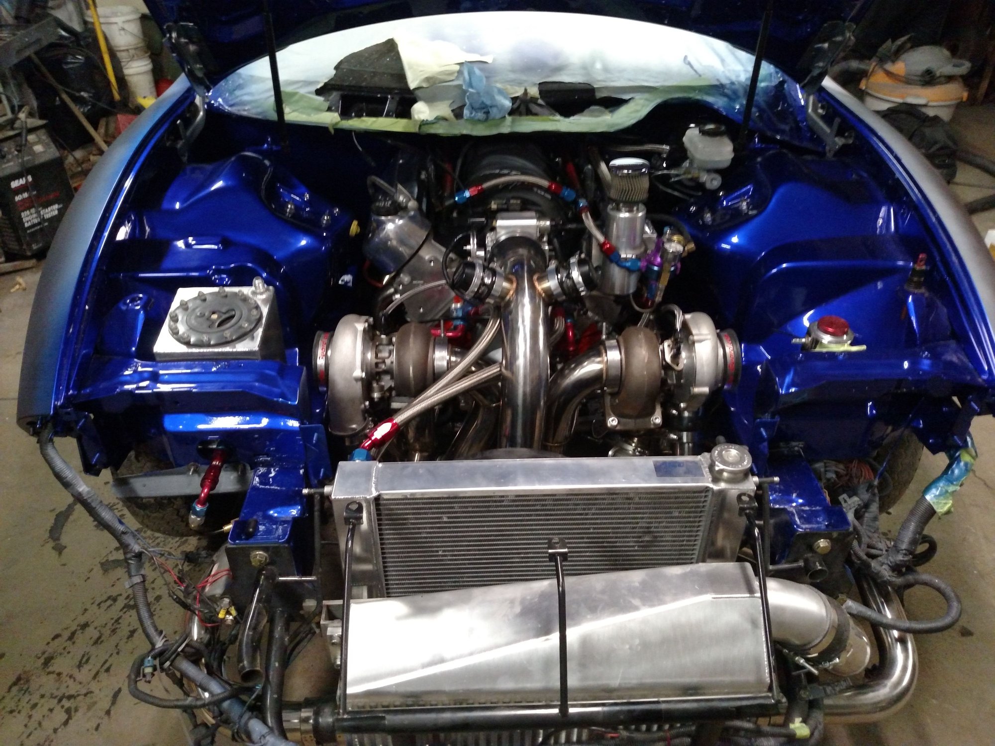

For those running the Twin T4 kit in their F-Bodies, what K-member have you gotten away with? I asked HS and they said it was built around the BMR Turbo Kmember and PA Racing Kmember but Im curious if anyone has ran it with the UMI kmember or any other Kmember without having clearance issues.
Also, I picked up this kit BNIB from someone on facebook and plan to make my own oil system for the turbos, any suggestions on how you routed yours? Going for the Cleanest look possible.
I would also appreciate any pictures of your Setups. TIA

Old Jun 19, 2016 | 10:33 AM
I tried it first with a Midwest chassis k member and no luck. Swapped to a PA turbo and fit like a glove. You really need that big bend on the front bars for the way it routes. Will try to get a pic later. Not quite running yet.
Old Jun 20, 2016 | 11:08 AM
stang_kllr's Avatar
Joined: Jun 2009
Posts: 363
From: San Antonio, TX
Originally Posted by lmt0705
WOW! Looks great! thanks for the picture
Awesome thanks for that info!! Im gonna pick one of those up.
