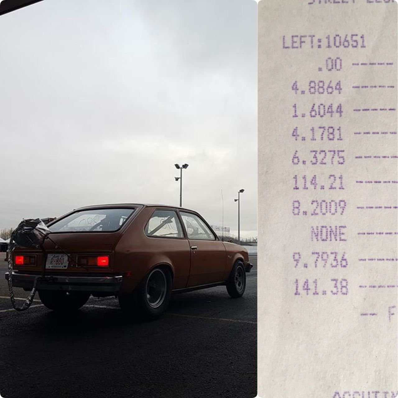

Turbo D's Avatar
Joined: Aug 2007
Posts: 216
From: Calgary
Had it at the track yesterday, went 139mph on 7lbs, 142mph on what I think is 10-11lbs. Stupid ms3 pro box keeps saying the logs are corrupt 50% of the time on the sd card. Back pressure is 2-3lbs above boost on all the runs. I think my car just hates the loaded dyno.

That's good news! Working well!

What was the final race weight?

2550 with me

My calculator says you are putting down aprox 550 hp, and that seems right to me for 10-11psi on that motor

I've seen a few guys run it, it's pretty dam close to the ljms stage 2 twin turbo cam. I'm going back next friday, hopefully I can get a 8.99/150mph out of it with it turned up a bit and leaving good.
