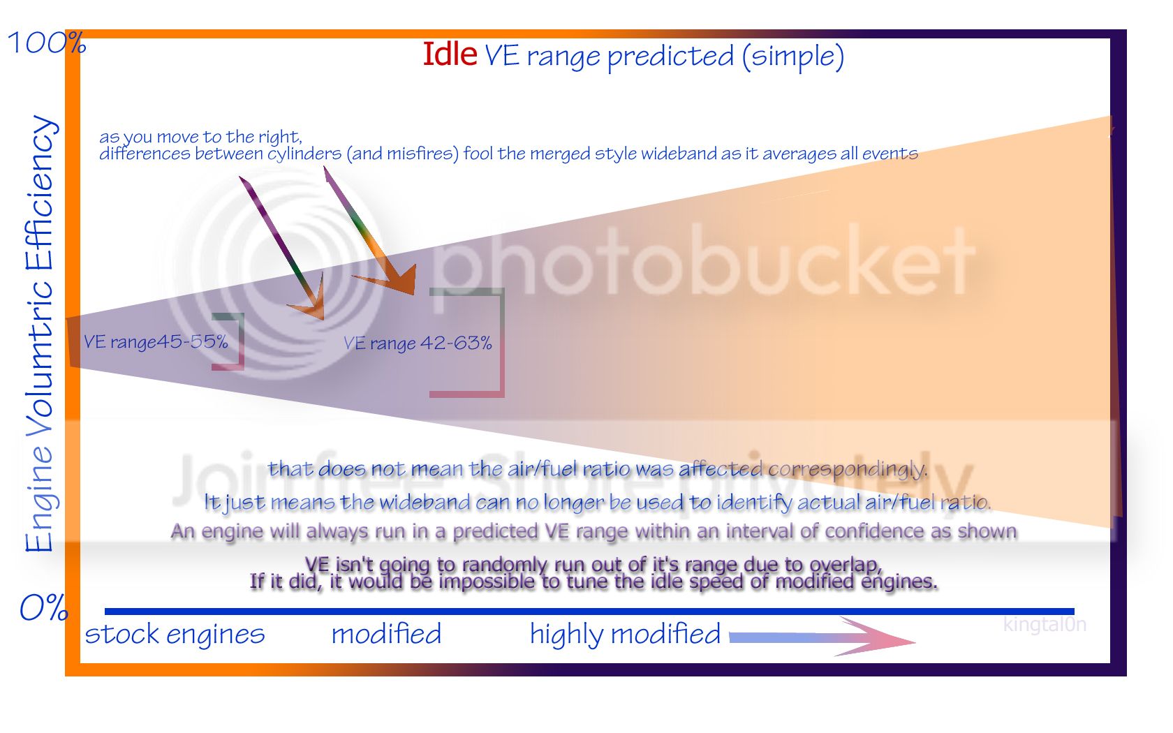

a picture is worth
hope this clears things up and leaves no doubt or room for error.
Now ask away any questions, happy to help

Legitimate question, what is wrong with you? That isnt out of a textbook or PowerPoint by a reputable source, that's your own crap. I literally posted a hotrod article disproving your theory and you respond with a picture you made. When you post factual data from a reputable source (aka not from your head) maybe your post will hold weight. I'll try this 1 more time for you, read it slow, than stop and reread it and realize it completely disproves your theory.
QUOTE- Just keep in mind the process tends to blend exhaust gas with fresh air/fuel mixtures. Plus, it also represents a portion of the combustion ingredients that take up space in the place where combustion occurs. By displacing some of the space that could be occupied by combustible material, it further reduces power as evidenced by lower exhaust gas temperature. It’s like a built-in EGR (exhaust gas recirculation) system.- END QUOTE.
Originally Posted by kingtal0n
a picture is worth

every word you type is 'your own crap'
I just put my words into a picture cause im sick of typing.
Now, you either find something wrong with it, or ask a question to get clarification, or step off. Every new thing that somebody invents is 'their own crap'- when a scientist doing research or a PHD creates a paper about Ebola virus or whatever its 'their own crap'. Just because it winds up in some kind of online journal or a book about viruses doesn't make it any more or less legitimate. Its up to the reader/observer to determine what is being presented and draw their own conclusions.
I updated it to include an xample for even more clarification. Hope it helps.
consider that even if a misfire occurs and the wideband jumps, that doesn't change the a/f ratio. It just means the hydrocarbons passed through un-reacted and might even react later in the hot exhaust tube. Also I probably had a stand-alone on a V8 before anyone in this thread, and have written software to control it.
