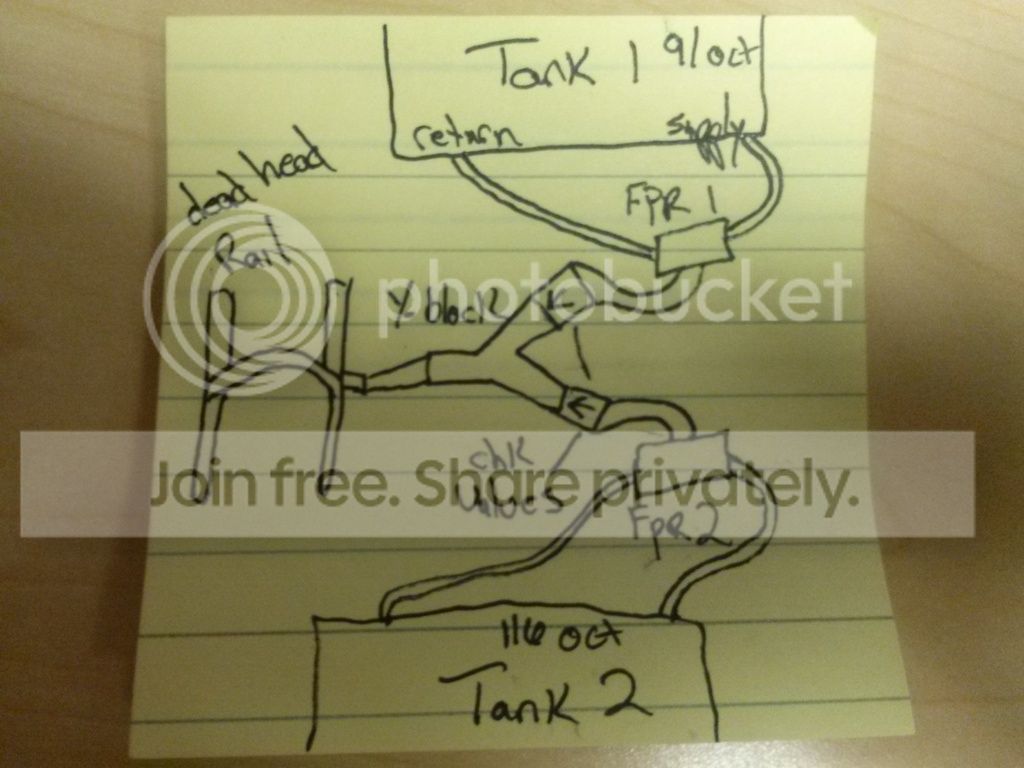

I think alot depends how much time you spend cruising. If it's an all out race car race fuel isn't much of an expense.
Buddy uses the ball valve setup mentioned above. Uses around .8 of a gallon of 114 octane each pass around 950whp. That includes warm up in pits, burnout, pass, and return to pits. The guys that run 16 injectors and have the C16 injectors come online in boost only use much less. They don't need crazy mechanical pumps, huge fuel lines etc. that ethanol/alky guys need to make 1500hp.
Using a setup like below with a dinky stock fuel pump in the main tank and a 4303 style with C16 would be cheap and easy as well. The pump getting power determines which fuel is fed. Have your C16 pump kick on at 1lb of boost and the pump gas pump kick off at say 2lbs. Was going to try it on my latest build but we can get E30-E50 at the pumps local now so that's even easier for my 600whp goal.

Now, I can get turbo blue 116 local by the 5 gallon pail, it's 95$. My 2jz car that rarely gos out of town that was built a few years before the LS car runs megasquirt and I use staged injection. So much like your picture, i run pimp gas and blend in/stage over fully to the 116 race fuel and lay down big power at will. Nice thing is, making a street pull a day, my 4 gallon race tank will last nearly 6 weeks. I'd like to run ethanol in that car but even on 116 I'm out of injector and pump
