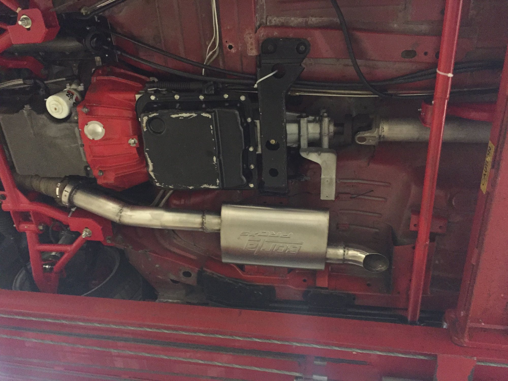

Old Feb 10, 2017 | 05:06 PM
ScottyBG's Avatar
Posts: 557
Likes: 9
From: Bowling Green KY
Just put a good muffler on it like this one. It made basically the same HP as an open down pipe,well within about 5 hp on a 700+hp setup. If you had a 4" cut out, you might gain more but a 3" strait through muffler flows pretty much the same as a cutout. You can check out the design on the Borla Pro XS mufflers on their web site if your interested.
