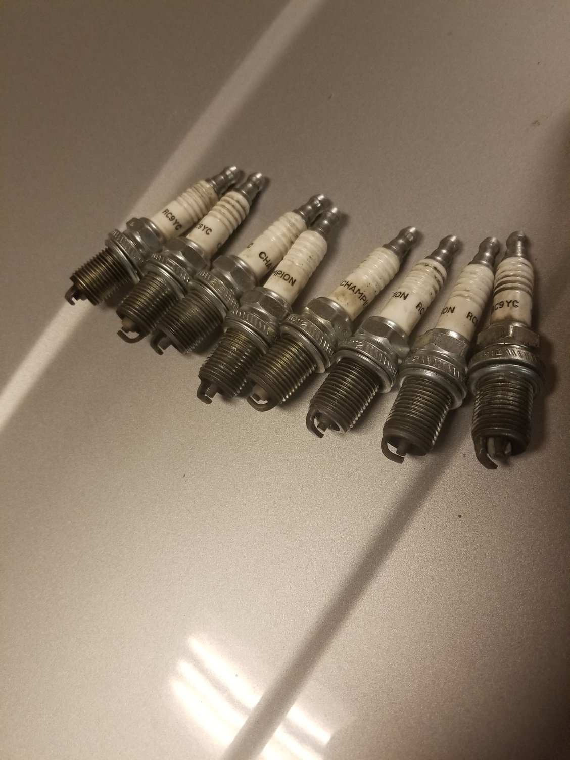

Is that pump gas or e85? Coz that seems like a lot for pump gas from my limited personal experience
just 93 octane. I had it at 13 before but the mark on the plugs seemed low. after that it was above the curve on the electrode
All our stuff I tune locally is 93 only and we typically dont run more than 14 degrees ever once full boost hits. Buddy's got a 5.3 @17psi 93 only and hes at 12 degrees peak and I start pulling timing aggressively once the IAT's get to 122*F. You have much more cushion for error on pump gas, especially if the AFR varies, if you keep the timing down.

That's what I thought when I saw the first picture but the plugs tell a different story. Most pistons show some peppering with detonation but I haven't burnt up enough to be an expert lol
Is the porcelain broken off of four plugs, or did I look at the picture wrong??

the insulator tip is def missing from a few.

Can you clean the threads off? It looks like in the 1 pic you have several turns of color in the threads. You typically only want 1 full turn of color....I don't know how those champion plugs relate to 7s, but they those threads also confirm too much heat in the chamber.
four tips are missing on the plugs. those champions are a direct cross to the 7s. I will clean them off and take some pictures

As said, they're fucked, you've detonated the **** out of them.
And use NGK or Denso instead of that Champion rubbish
