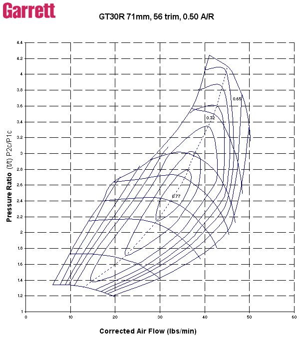

A pair of 3071's
This is probably the most expensive, most reliable, to purchase authentic garret turbos from ATP.
The map is very flexible, you can see we are still on the map when the engine is making only 400 horsepower and coming up in boost (3-7psi range) is still very well located on the map. This is important on the street because the engine won't be making max power all the time.
Looks very good to me, the more I inspect it (twins) against a healthy 5.3 the more I like it.

A pair of 3071's

each turbo good to 500
so theoretically two are good for 1000 horsepower.
15% generic losses gives us around 850rwhp
I see them supporting 800rwhp
You said 100% street car so the next size up is incomprehensible, given the nature of exact numbers (exactly 850 horsepower isn't nearly as important as anything else)
