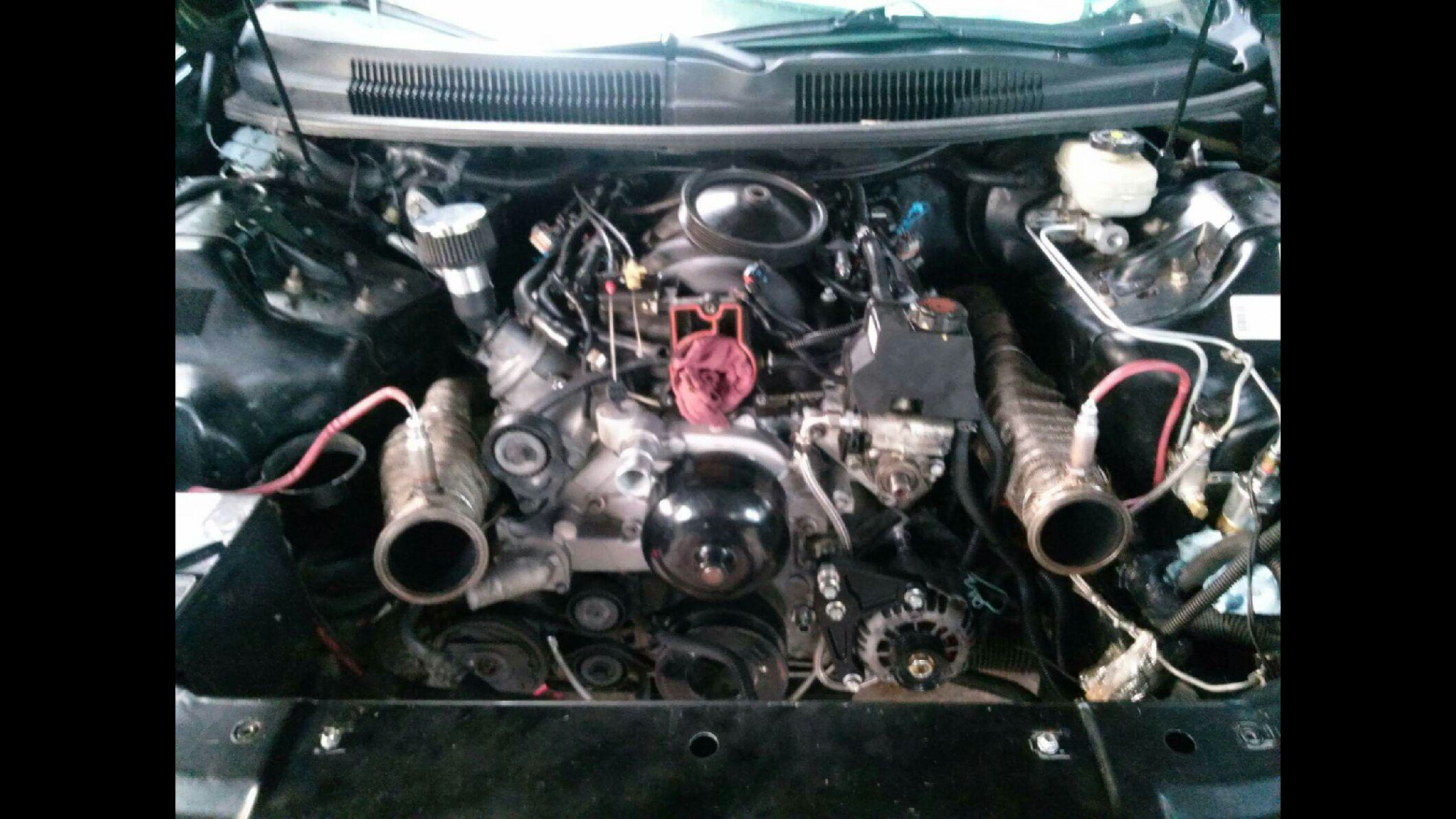

So this is my set up although that's not my car. Same kit though. I'd love to put a t6 borg. Just with how large they are I don't think it will physically fit.
