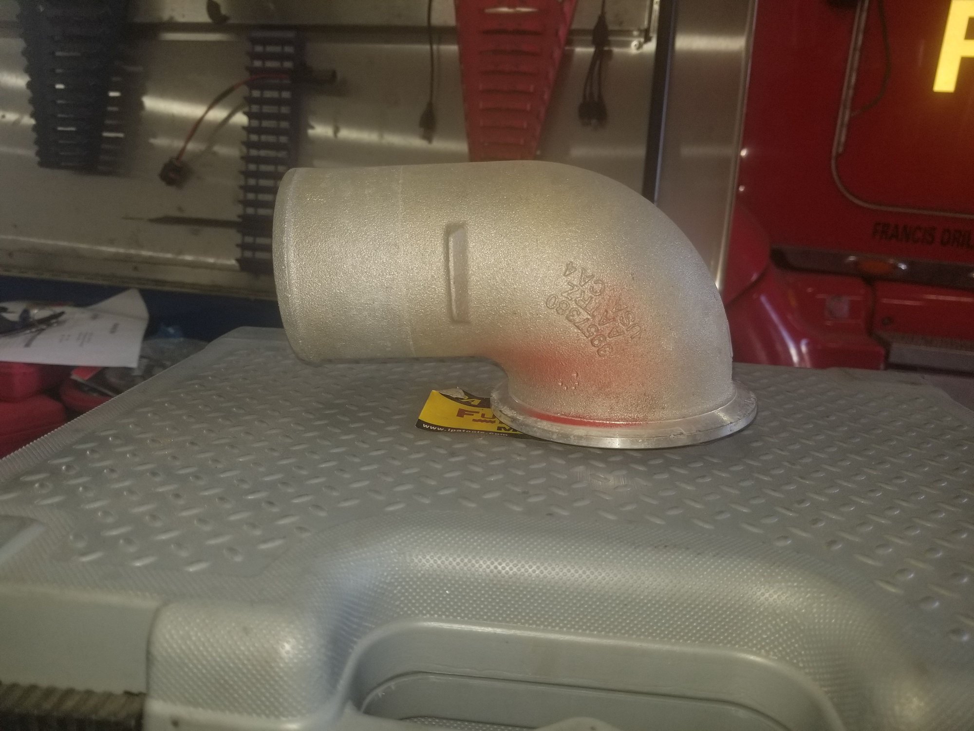

Hey just an fyi for everyone. I have needed a 90 compressor discharge pipe for my s480 standard cover and haven't been able to find one. I was about ready to buy another flange and
weld a 90 to it but I work on trucks and I found a 6.7 cummins intake pipe is the correct flange and is a very tight 90. Part number is 3957380. It sells for 41 bucks straight from Cummins.

Discharge of elbow accepts a 3 inch air to air hose.

Very cool and good to know! Not a bad price either.
