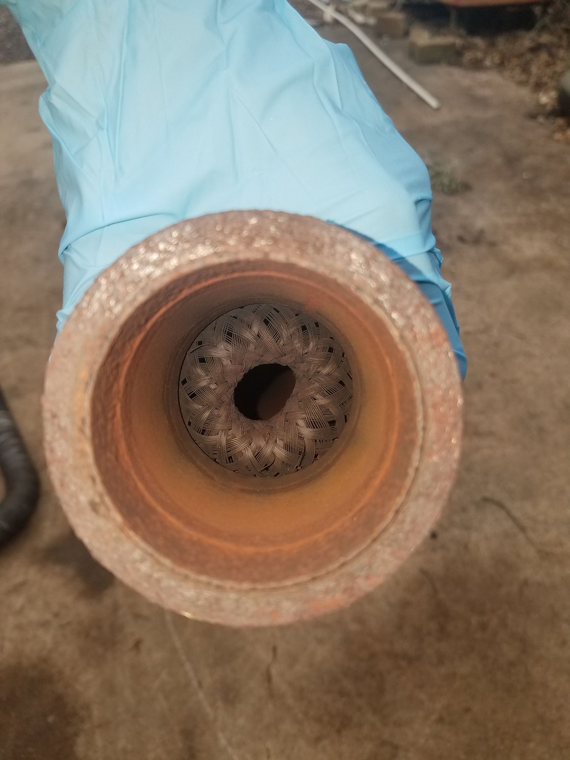

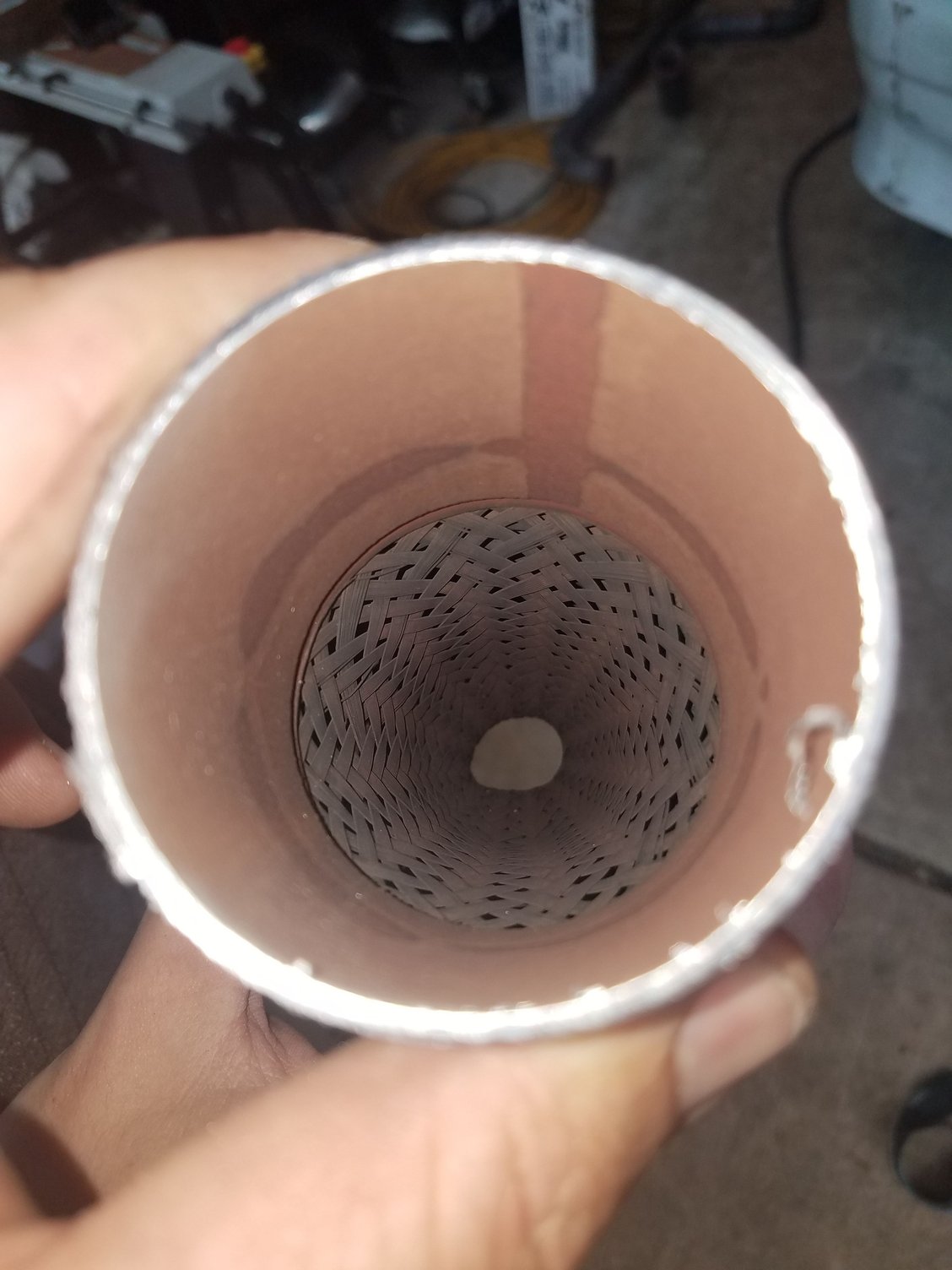

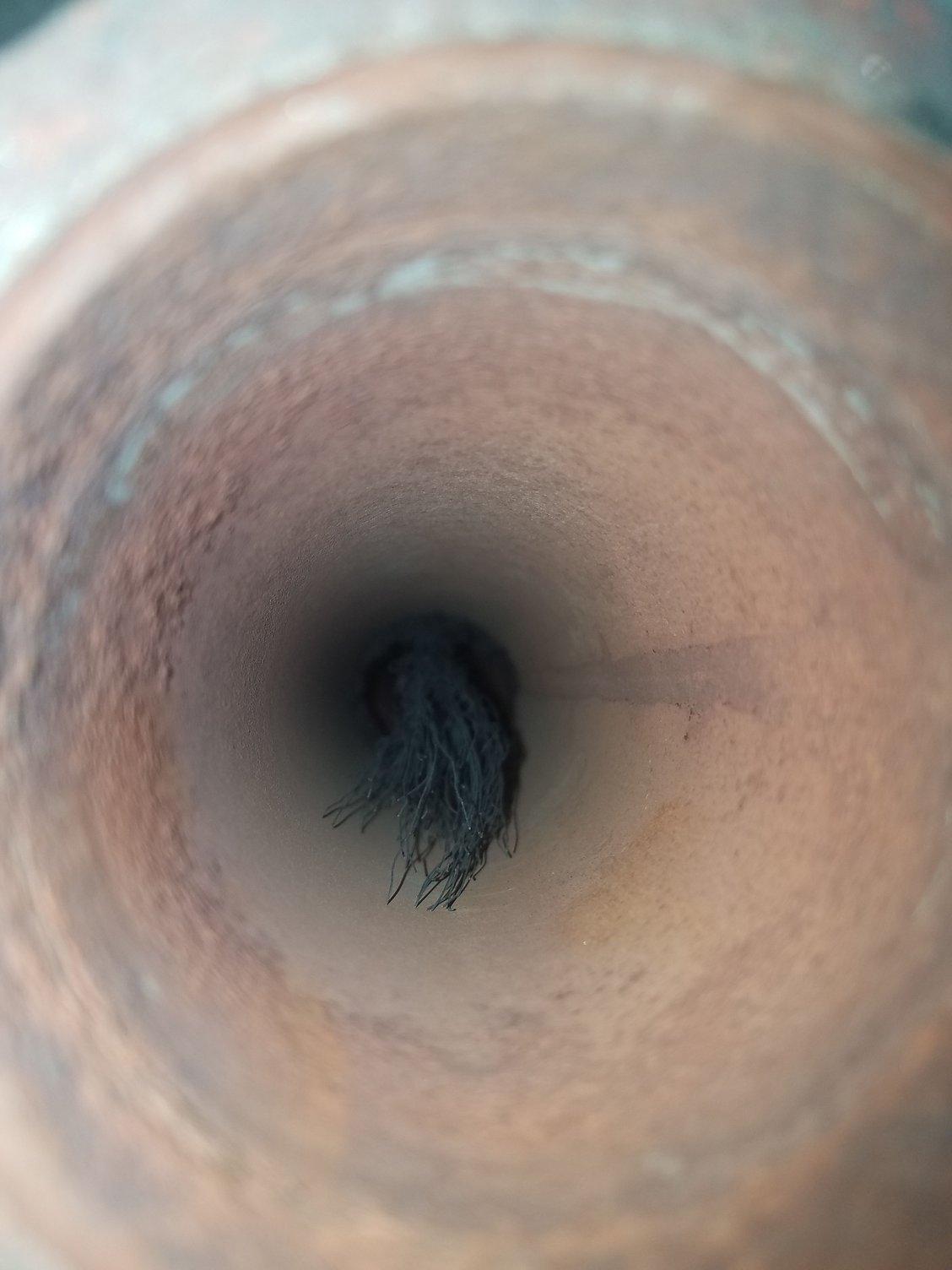

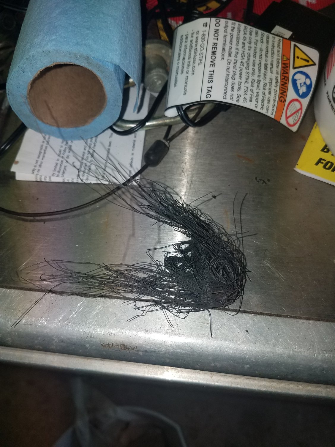

Get rid of that stainless braid flex connector. Its going to come apart and choke the crap out of the exhaust and then end up inside your turbo housing and wheel. Ask me how I know. 1 was completely gutted already and pieces were in my housing.

Yup!!! ^^^
Exactly why I didn't use one. If you support the turbo like you should and don't let it hang off of the pipework you really shouldn't need one of those flexy things anyways.

I just ordered a borescope, so I'll take a look through the O2 sensor port for now to make sure its not coming apart I will put a flanged connection in its place later on.
