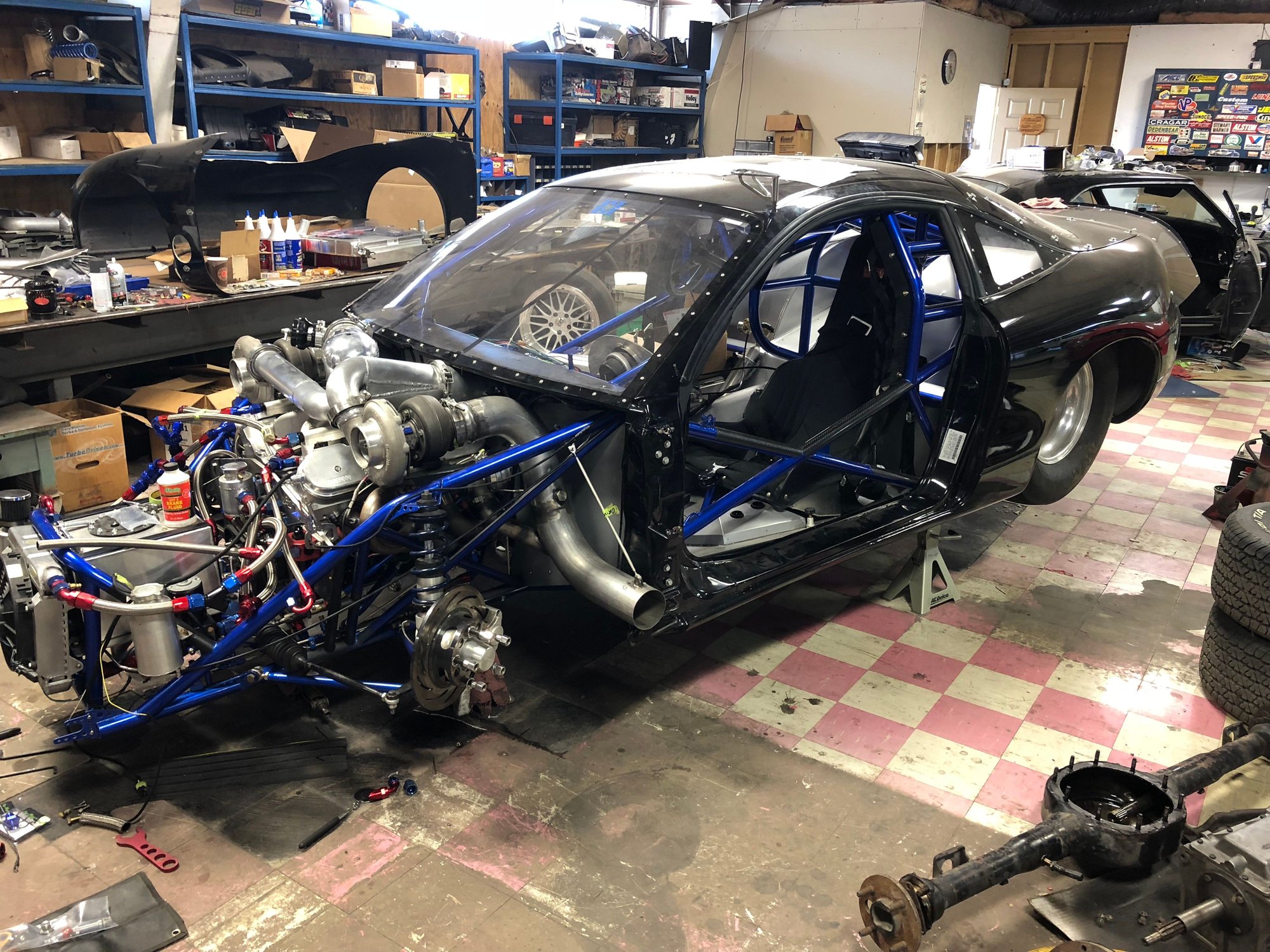

New build on the chassis dyno. Twin 66mm 427 with tial 44mm wg on each header. Started getting creep at 15lbs. It creeps up to 19lbs at 6500. I think the problem is that we are coming off at 90 degrees on the collector. Was wanting to get some feedback before going with larger wg’s. Made 1113 at the wheels with 960 ft/lb. think we can get a couple hundred more out it, but need to control the boost better first. Thanks for input.

Post up some pics of the setup. Screamer pipes or recirc’d wastegates?

Hard to see. Will try get better tomorrow. Dumps into 4” exhaust.
