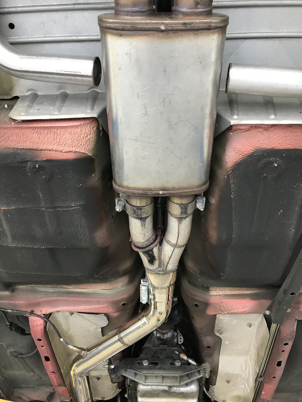

I ran my 4" underneath, then split it into 2-2.5" duals, both have mufflers.
Surprised in a truck you cant run one 4" all the way back, I did it on a 65
Buick, 2 mufflers, over the rear to the rear bumper.

What are those horns coming off the pipes after the muffler? For drone?
