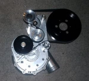

You mention a tensioner....exactly what are you using for a tensioner, details or pictures of belt system ?

the aster bracket uses a ls1 belt tensioner . This isn’t mine put this is what mine looks like . It’s raining out or I would take a picture of mine

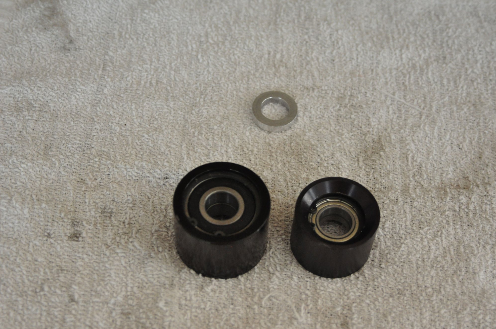

This is a real long shot, but you have checked almost all possibilities. Please bear with me. I know it's a stretch.
The lower bottom pulley is very small. As a result it has a smaller diameter because the pulley is smaller. The smaller a pulley the faster it spins which causes more heat and shortens bearing life. The bearings in this pulley are 6904’s. The 6904 is also not as wide compared to the 6203 below which is 12mm. These two small metal shielded bearing spin very close to their max rpm threshold. They are metal shielded too and don't keep out moisture as well as nylon shielded.
The common size bearing in most GM idler pulleys as well as the idler pulley on the D1 SC J bracket/Aster are 6203 –style with a 17mm standard ID. The 6203 series is a common off the shelf bearing with plastic shields (if spec'd so). Measured width at the ID is 12mm - wider than the 6904 bearings. The narrower 6904's means less surface area - more heat.
So what you say?
If any of the bearings especially in the the lowest pulley is galled and not spinning freely, the belt might be slipping over it, heating up the belt and immediately causing belt stretch after a run or two. If the green on the belt is shiny or starting to wear off quickly that would be a tell tale sign as well.
I replaced this pulley with a 50 mm CTSV Metco pulley (the one on the left) that has the larger 6203 bearings because I didn't want to have to keep checking those little bearings, or what might happen if/when they fail at 6K.
The Gates RPM product line (aramid layers) doesn't stretch if any compared to the HD green series. However, it is hard to find in stock and very expensive. It's something you might switch over too, when you get your 'losing boost' issue resolved. Its part number would be Gates K080530RPM to match your Gates K080530HD.

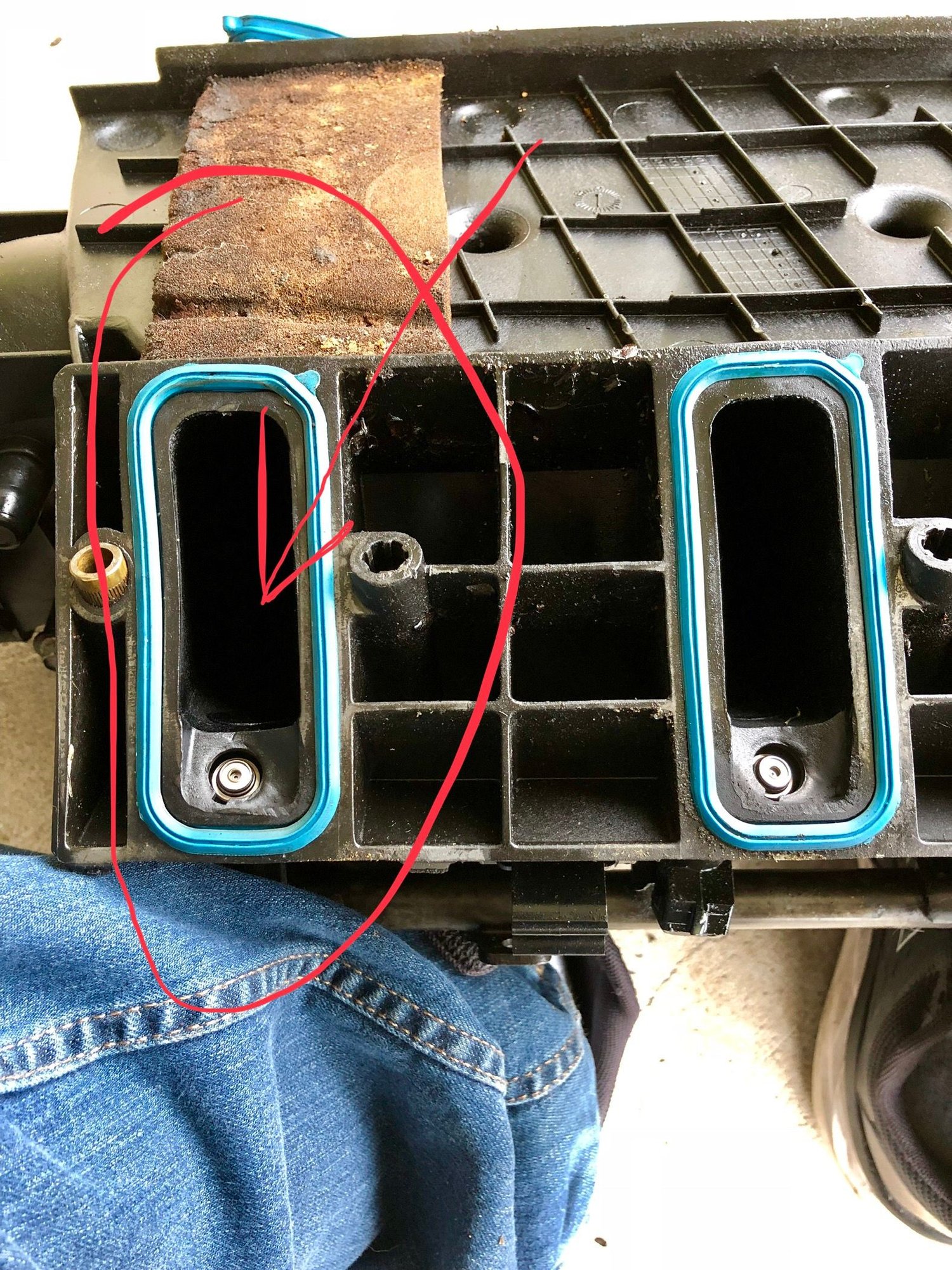

we found some bubble coming out from under the intake . When we took it off we found one of the runner curved in some idk if it’s normal or not . None of the others are like that

What was the result of the pressure test ?

it was fine . Found the map senor leaking but that’s it

So the intake did seal fine during the test ?
It must be belt slip then

yea I pulled it off and put it on a buddy spare set of heads . We soaped up everything the only thing we found that was leaking was the map senor

My aster never slipped with either the d1sc or the f1a, spinning both to max rpm. For the F1a I went ahead and pre-emptively got the CBR 8" pulley to keep a larger pulley on the blower while the engine was exposed, always an option if you think slip is the culprit. Also make sure and try a few runs with the filter/elbow off, those can choke your boost down too.
