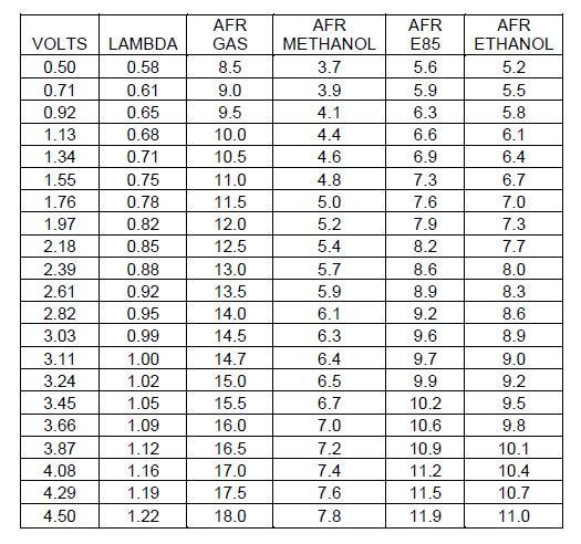

Found this in a quick search, so no idea how accurate.
And this looks like a good read ?.... I'm not up on E85 since its not in my area...yet
