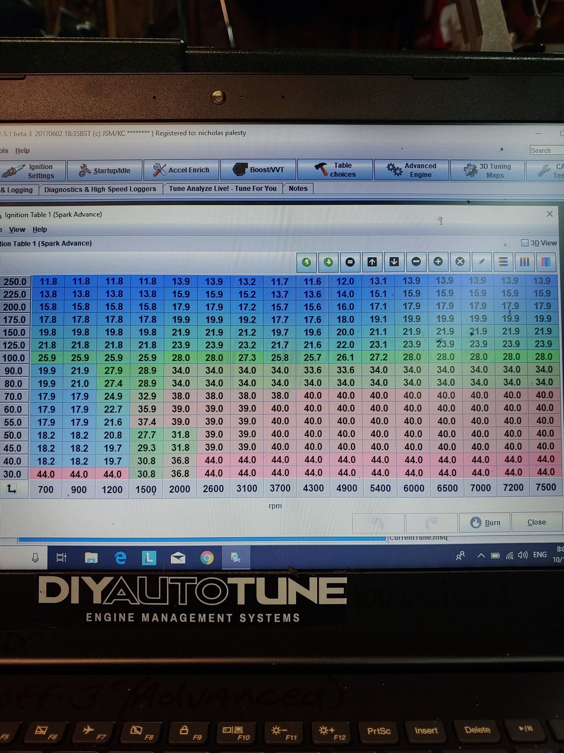

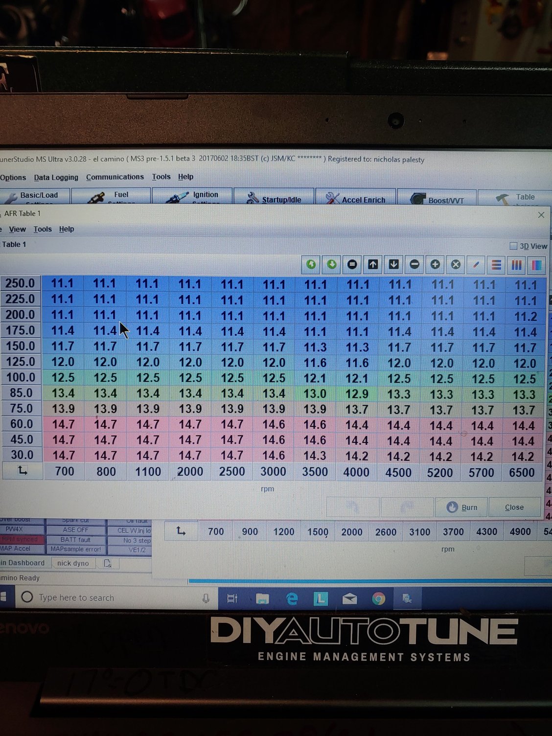

then i check tune in it now and timing seems kind of high and maybe lean afr in some areas,i dont know this is why i asking you guys for help.i put pics of my tables.when i fix i dont want to mess it up again.but i will keep trying til i figure it out with some help

Not familiar with ms3. Timing table doesn’t seem very smooth and somethings I would change. 34* at wot at 90kpa is too much imho. Most people find they make the most power at 28* or so on these engines. That said but doesn’t really appear to be over timed in boost. If you were getting detonation bad enough you probably would have heard it. Sounds like coffee beans being shook in a metal can. What girl are you using?

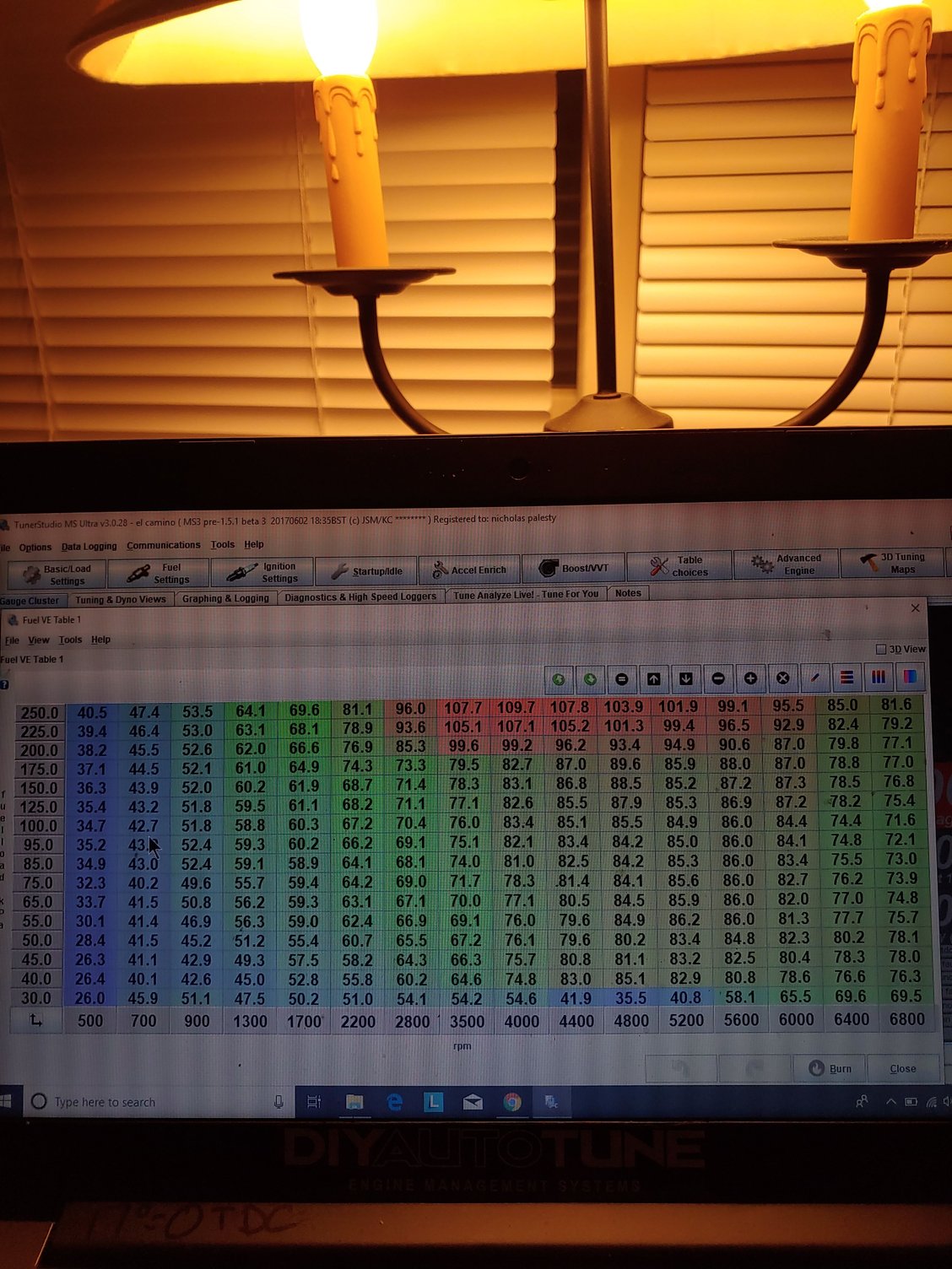

that table looks like a commanded afr table. Do you have a normal VE table and a log of your runs when you think you hurt it? Curious to see what your actual afr was compared to the commander afr. As well as timing logged during the runs.

this is the current ve table

That long only has a real short pull to 5k at 7psi according the the logs “boost psi”.
About 21* of timing at 7psi. Afr after 4600 or so got a bit lean at 12.4afr which is .7 off your commanded. And Right before you let off the afr jumped to 18 then to 19 (and you were still at 100% tps) then you came out of the throttle. More logs to check out could be helpful to see if there is any trends with that goofy ness going on with the fueling.
Nothing really jumping out at me outside of that in that little log though. Very well could have hurt it before and something finally gave up when you took it out for a spin that last time. Pretty curious myself now. I’m not familiar with MS so maybe I am missing something.
I am no expert... but I haven’t hurt a motor yet 🤷dum♂️ Could be just dumb luck on my part (sometimes it’s better to be lucky than good).

What fuel are you using? If you're on pump gas 17-20 degrees of timing at 175-200kpa is rather aggressive imo, especially in the upper rpm range.
using pump gas 93 octane no meth injection. i agree with you i thought it was aggressive also and i notice the knock sensors arent set up to retard timing
