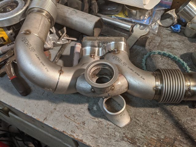

Thoguhts and feels on WG placement? (the hole in bend has been opened to the full diameter)
And full kit off the car ready for final weld
Old Feb 22, 2020 | 08:26 AM
mightyquickz28's Avatar
Joined: Feb 2003
Posts: 2,145
Likes: 133
From: East Chatham, New York
Looks good. I think the wastegate placement is clever. It meets the requirement of having the correct angle off the parent pipe. On the downpipes enlargement immediately past the turbine housing, I'd thought about doing that too. Where did you find the transition?
Old Feb 22, 2020 | 10:28 AM
Shownomercy's Avatar
Man-Crush Warning
Joined: Jun 2009
Posts: 3,197
Likes: 130
Oddly enough on amazon
https://www.amazon.com/gp/product/B07BRB9K9Q/ref=ppx_yo_dt_b_asin_title_o09_s00?ie=UTF8&psc=1 https://www.amazon.com/gp/product/B07BRB9K9Q/ref=ppx_yo_dt_b_asin_title_o09_s00?ie=UTF8&psc=1
Chopped the ends off to get it tight to turbo and voila
