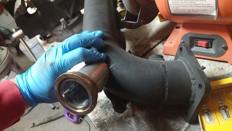

Originally Posted by AwesomeAuto
Sounds like you bought any one of 10 different turbo kits that put the gate in the crossover instead of in that passenger side turbo manifold.
You'll always have trouble controlling boost there. You can upgrade to a larger gate, but it won't be as simple as clamping it on.
A larger fitting will need welded onto the piping if you want it to actually make any difference.
Correct. The way my KB racing turbo manifold is designed, there is no good place to put a WG on it. It's a quality piece and I'm glad to to run it but this would be a downfall for it. The problem will be that no matter what I do, I wont be able to vent any exhaust from my driver side bank. I went back to a stiffer spring combo this past weekend (rated at 11.6lbs instead of 8.7lbs) and saw more boost in all 3 gears as someone on here predicted. 12 lbs in first, 14.5 in 2nd and 16.5 in 3rd. I'm actually ok with this result for now. I will re position and install a larger WG in the future to get a more consistent boost number across the board. I'm running the Holley Terminator X and have failsafes set up for just about everything I could think of - overboost, high MAT, fuel pressure, oil pressure, knock, coolant temp etc etc.
I added a gate to my KB manifold and was able to get boost down to 5 PSI.

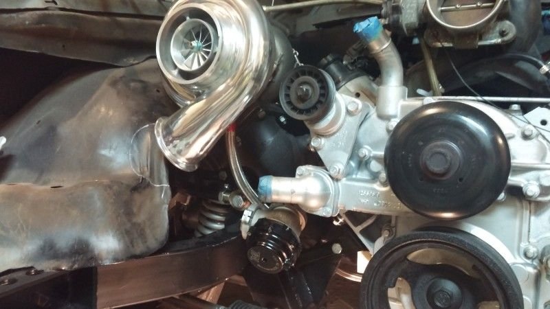

Old Feb 26, 2020 | 02:15 PM
drhill's Avatar
Joined: Oct 2016
Posts: 30
Thanks for the pic! I'll have to look at mine again, In my application (84 Mercury wagon) I had him build a custom low rise manifold for my driver side. I don't remember having that much open area on the pipe to work with nor room for a gate up there but I'll look again...
Old Feb 26, 2020 | 02:24 PM
AwesomeAuto's Avatar
Joined: Dec 2019
Posts: 1,129
Likes: 478
Mine is the low rise version too for my Nova.
Old Feb 26, 2020 | 02:31 PM
drhill's Avatar
Joined: Oct 2016
Posts: 30
awesome! what size gate is that?

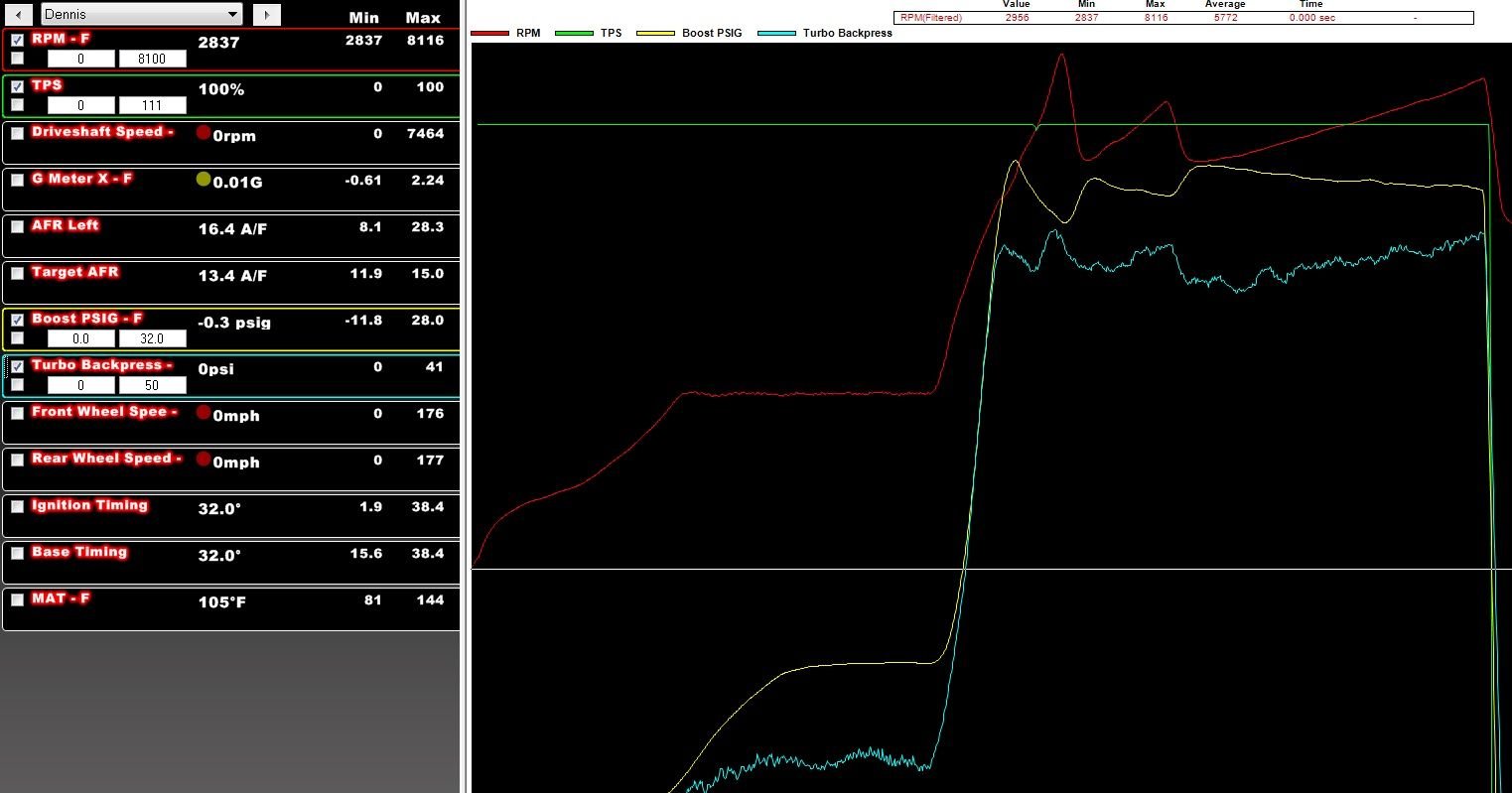

PS. Who here actually logs the actual back pressure?

Originally Posted by islander033
LOL.
Several guys on here have posted threads where simply coiled a tube and mounted an eBay transducer on the end to be able to log back pressure and then posted boost vs. BP. It's something I should have done with my rear mount, but with a new larger billet turbo being 260 shipped, I jumped straight to the solution that followed my hunch lol.

I thought both your cars were blower? The 03 is a turbo?
The cobra has been turbo for a long time. That log is a 7.82 1/4 pass on a bullseye 88mm NLX.
Nice, that turbo is no joke. Pics of the setup?
