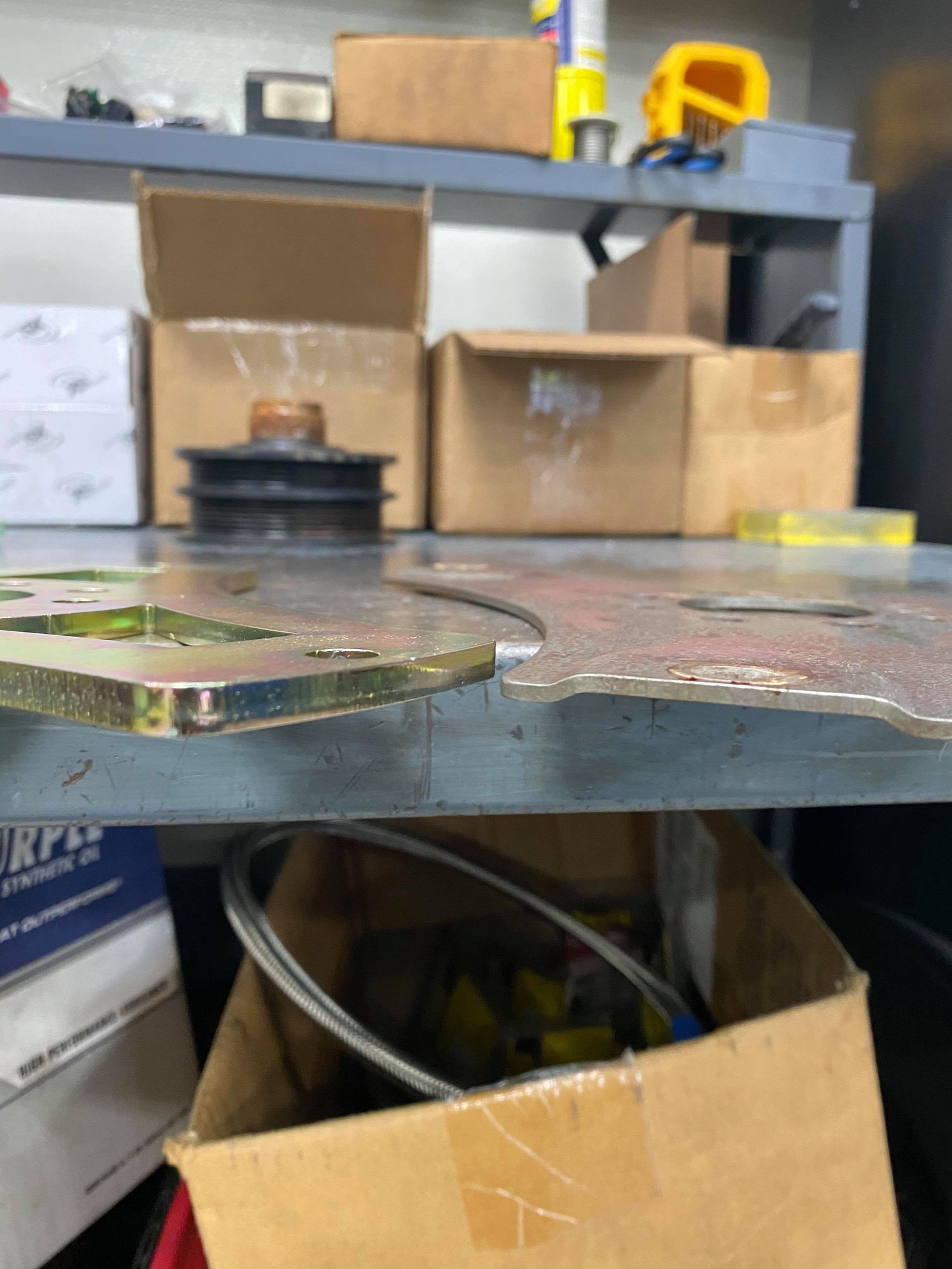

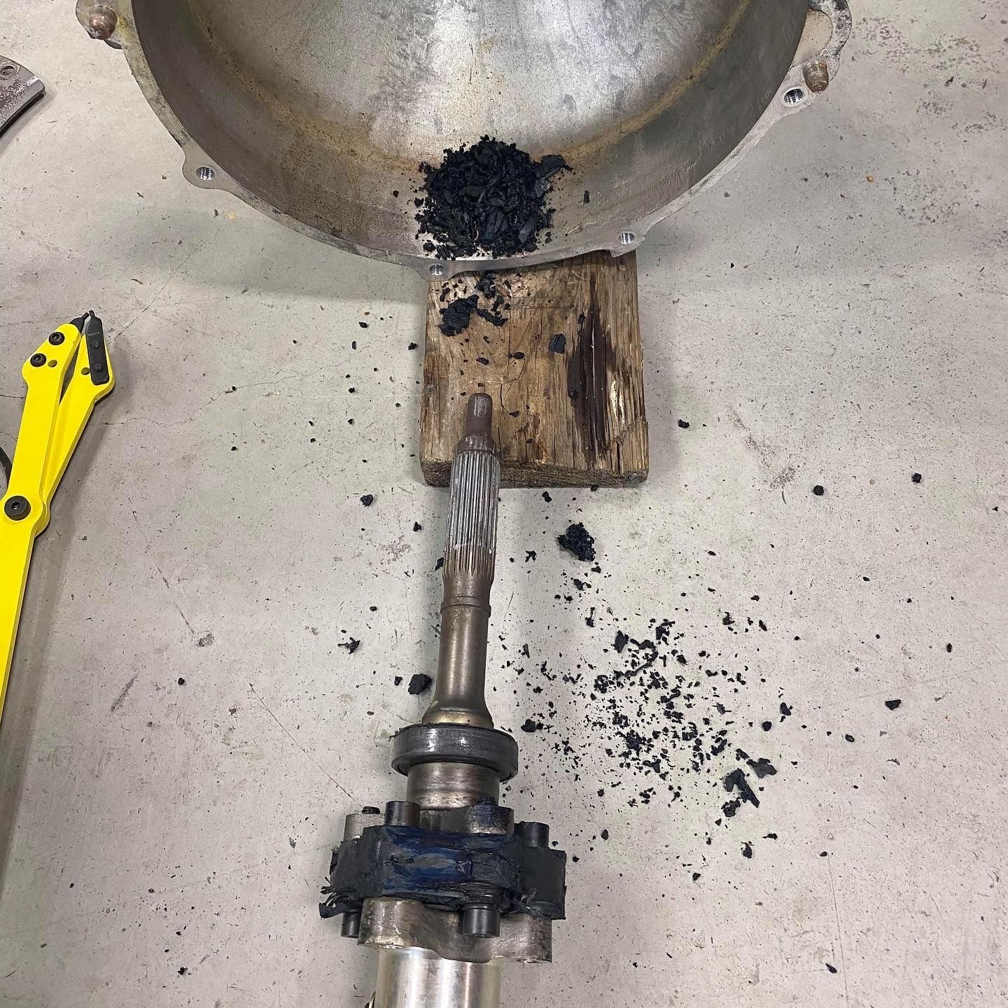

Checked on what’s left of my rubber couplers and a few things that came in like my Rpm billet converter plate, dss 3.5” aluminum couplerless driveshaft, flexplate amd flexplate cone.
Huge difference in thickness
