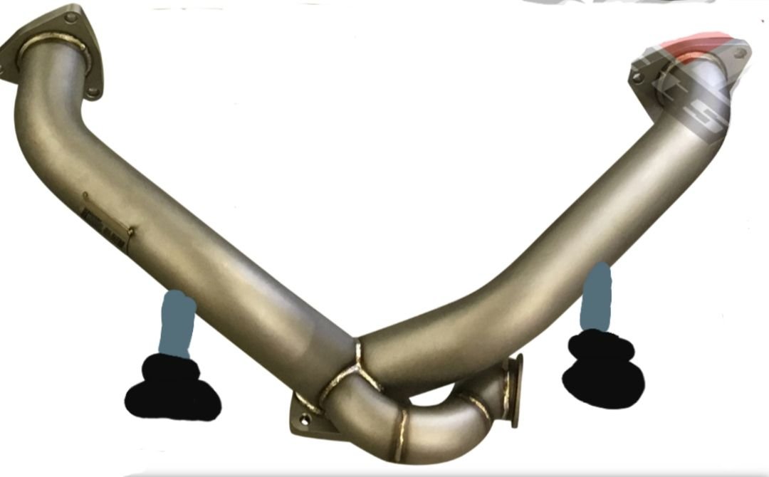

Looking at my available space would this work and just getting rid of factory mount.
Because your adding a second gate, that’ll probably work.
But ideally you want the flow from the crossover into the wastegate STRAIGHT. In your drawing the exhaust flow has to take a 120* bend to get to the gate.
Don’t think of the gate as just releasing exhaust pressure... think.. flow.

So this would be better

Definitely
