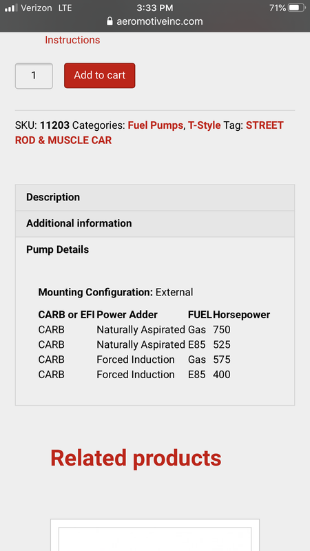

So 150 gph pump. Will not work. For a single turbo under 750hp. Anyone run anything like this.

As per aeromotives instructions and the description, that pump will handle 575 carb forced induction on gas and 400 on e85.
