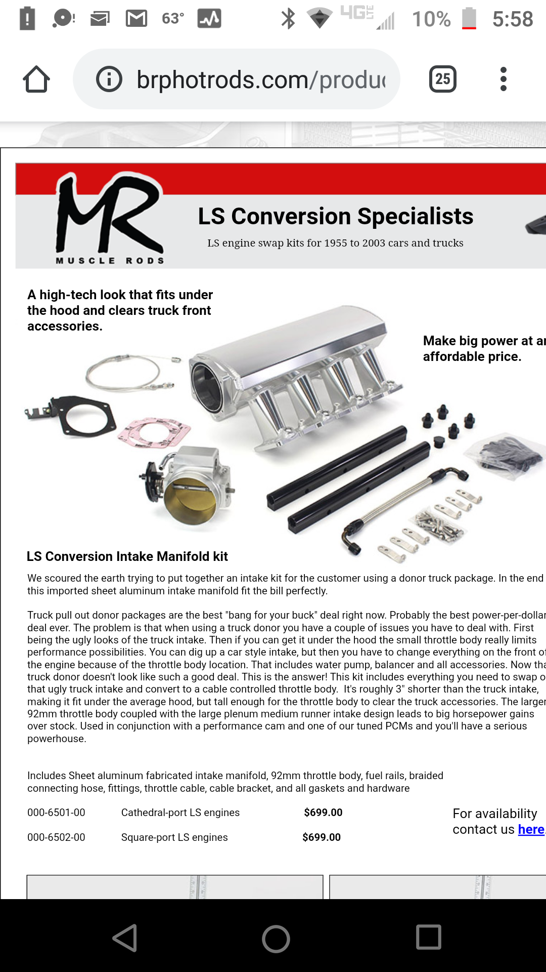

I'm looking at the car now, is there any way if I use ls1 oil pan and intake in picture(short ram that clears truck accessories) that I couldn't bolt directly in. Manifolds will be in turbo kit. I'm not against swapping everything over but wouldn't it be awesome to be able to drop in a nearby complete setup without changing everything every time and just running the truck 5.3 hard?

I’m pretty sure that intake won’t clear the windshield cowl without cutting the cowl and the truck alternator sits too high and will hit the hood I’m pretty sure that’s why everyone runs fbody accessories. It’s literally nothing to swap over the brackets just a few bolts and some time. Around 6-700 hp a motor will last a good while with a good tune especially if you are able to run e85. You won’t be swapping them as often as you think for it to be inconvenient to swap over your fbody brackets.
