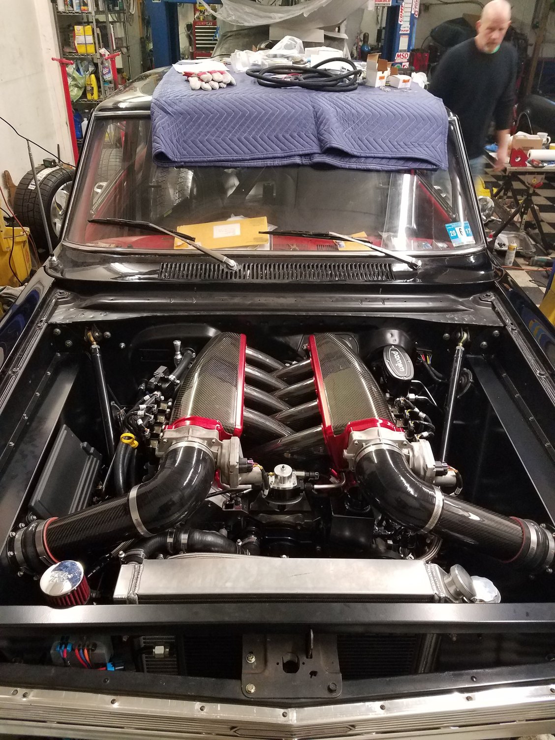

Old Jun 2, 2020 | 05:32 PM
Project GatTagO's Avatar
Joined: Mar 2003
Posts: 10,617
Likes: 1,883
From: Little Austin
Originally Posted by lemans1
I was inspired by a Cougar build on this site where the owner built what was basically a dual quad tunnel ram from a Holley hi ram. ....
Thanks! :-D

Thanks! :-D
Andrew
Hey, thank you! I loved reading through your build. Very well done. I know it takes a ton of time to document, organize, and post up all of the details of a build, much less the time actually working on the car! It is much appreciated.
