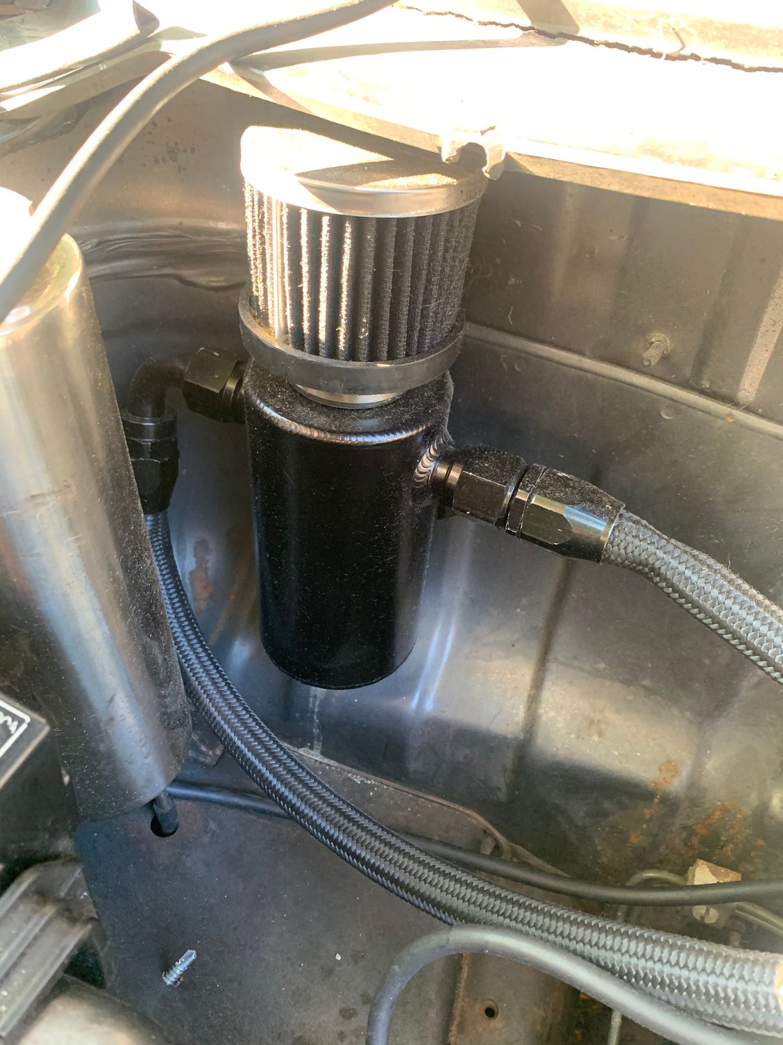

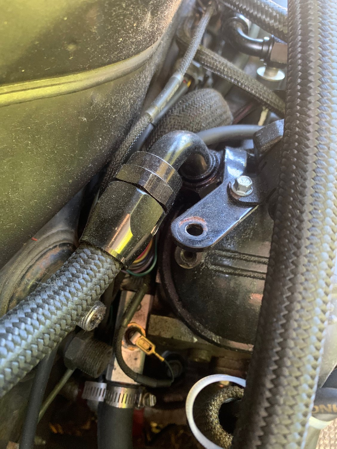

my car has a -12 AN fitting on each valve cover to a single catch can. At idle you can see some air on chilly night coming out of catch can filter. Other night I was beating on it pretty good with heavy load, 160 in 4th gear, several times and I notice my oil dipstick came up alittle and oil was all over my frame rail. I can only assume it’s from dipstick.

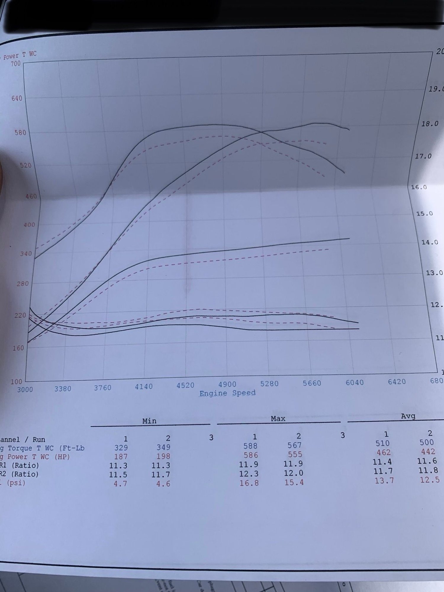

my car falls off power at higher rpm for whatever reason 🤷🏻‍♂️ And was wondering if this is related to that. Look at the sheet, I rev to 6800. If continued the pull on dyno than you would see if shoot power back down pretty good.

How is current catch can vented? 2 -12 should be enough to vent motor. I suspect you have > 3psi in crankcase to blow dipstick out. A basic vacuum/pressure gauge connected to dipstick tube will give you a quick read.

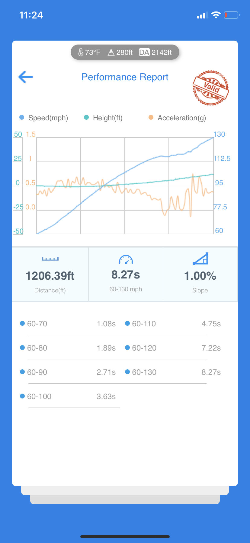

SIde note - based on dyno graph, it appears that peak hp occurs around 5800rpm and projecting to drop 10% by 6400. Am I seeing this right? If so, must feel flat at 6800? Are you using a phone app to monitor acceleration results at different rpm?
my top of 3rd I always thought felt slower than should but I do know my power falls off decent bit. Also can see the catch can and both lines going to valve covers near firewall.
my 100-115ish before shift slows down for sure. Tech. I shouldn’t have shifted till 122 and slight upward slope but I still have a top end drop of power to figure out. Just wasn’t sure if it’s related to the blow by. I don’t blow out dipstick unless top3rd gear into 4th
