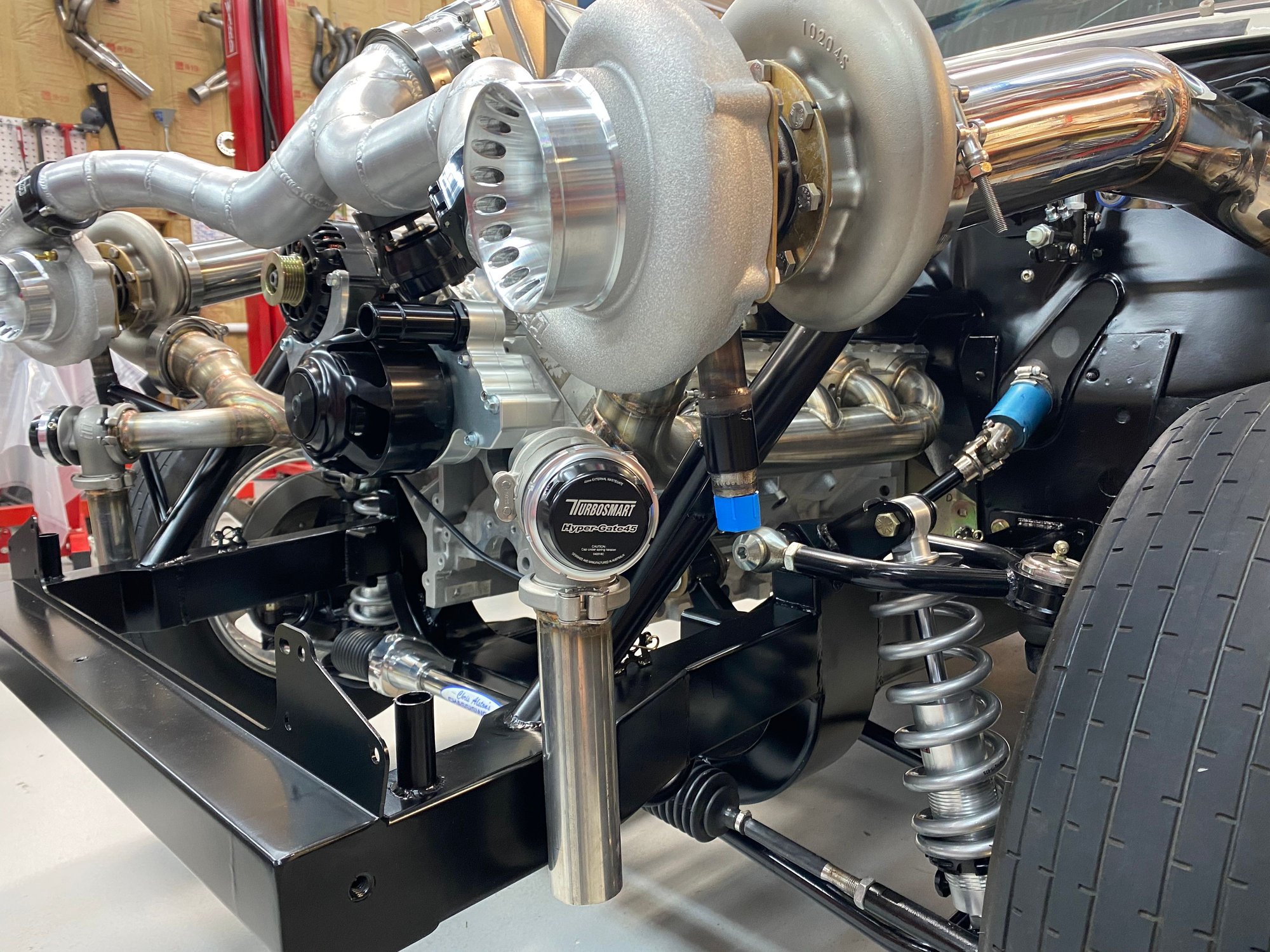

Going to post some pics of my 1966 Nova SS street car project. Been about 14 years in the making, LOL. Life and kids, career, etc. Long time car enthusiast, drag racer, engine machinist/builder, etc. Put together alot of different stuff over the years. I think I have had 6 or 7 different LS engine configurations mocked up in this car over those 14 years, and even started with a pump gas 555 BBC when I first put the Alston Chassisworks front clip on it. At one point, I thought I was going to race Real Street at the LSX Shootouts with it, but never could find the time to get it together. The rules seemed to change yearly and that didn't help. Kind of glad I never put it together then because it would have gone down the race car road and probably never returned. Too nice of a car for that.
Finally settled in on a combo, it will be a twin turbo set up. Precision 68/70's and Shearer A/W set up sitting on top of a 417 Motorsports billet lower intake.

Nice!!! What brand of log manifolds are those?
Thanks.
Old Sep 22, 2020 | 11:56 AM
helicoil's Avatar
iTrader: (104)
Joined: Aug 2006
Posts: 1,866
Likes: 319
Thanks.
They were made by my fabricator.

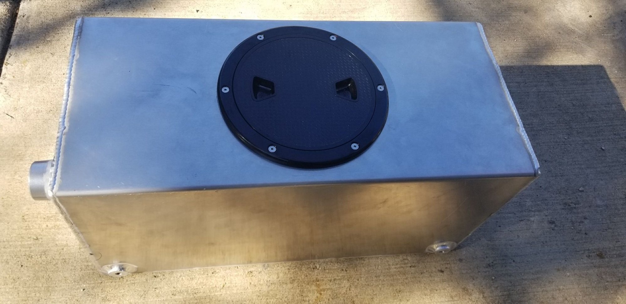

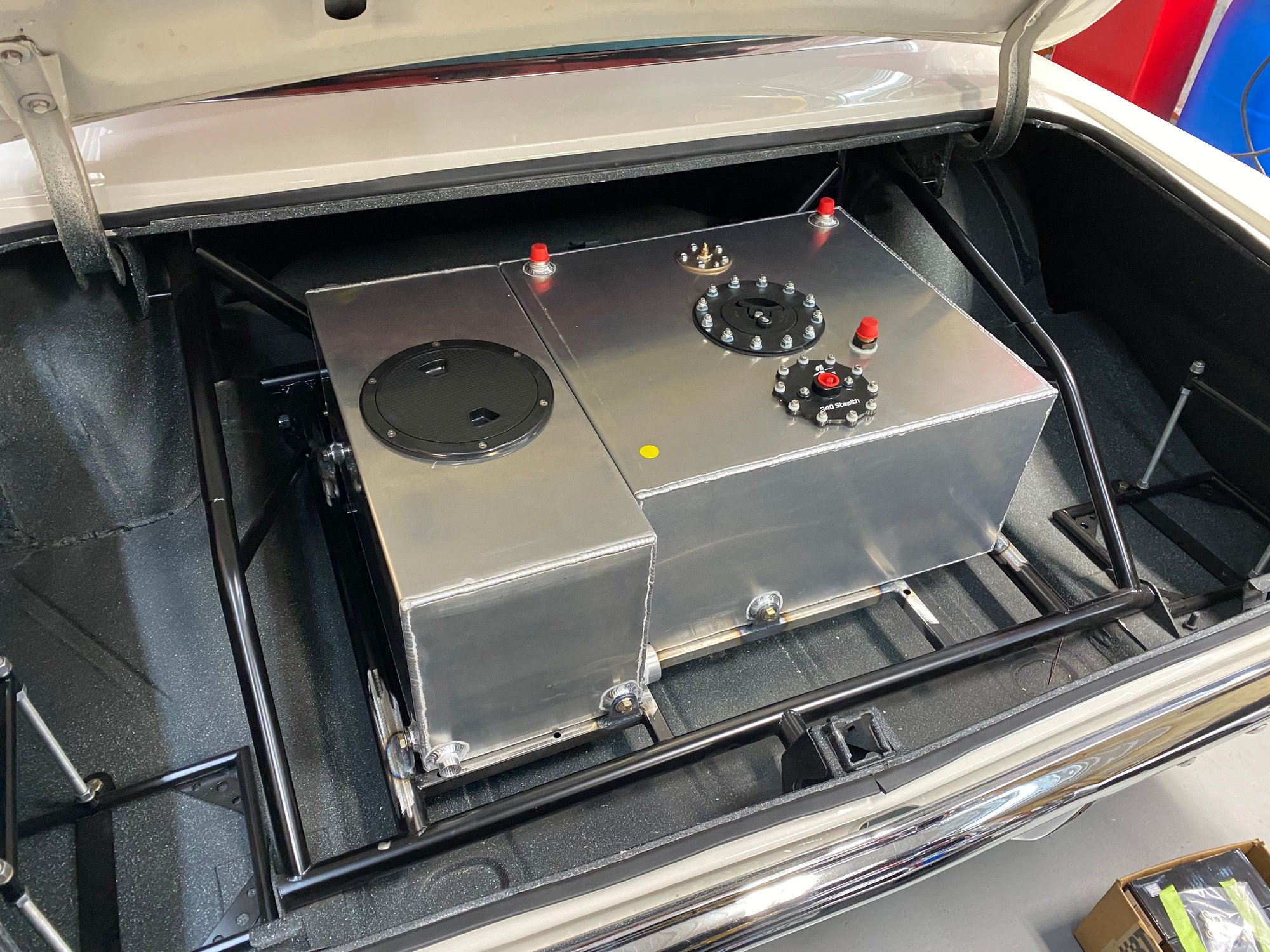

Is the tank next to the fuel cell your a/w tank?
Old Sep 22, 2020 | 04:33 PM
helicoil's Avatar
iTrader: (104)
Joined: Aug 2006
Posts: 1,866
Likes: 319
Yes. Still need to mount a water pump back there.

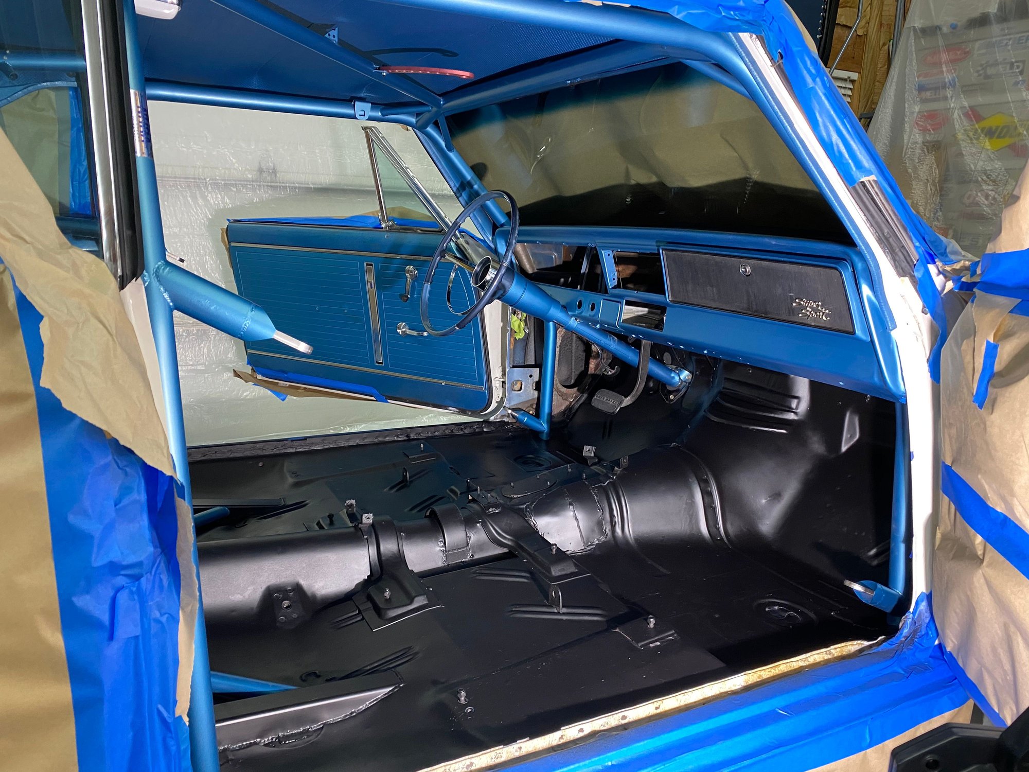

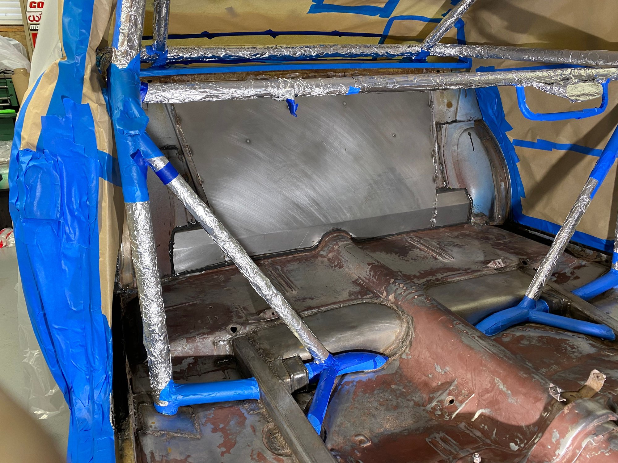

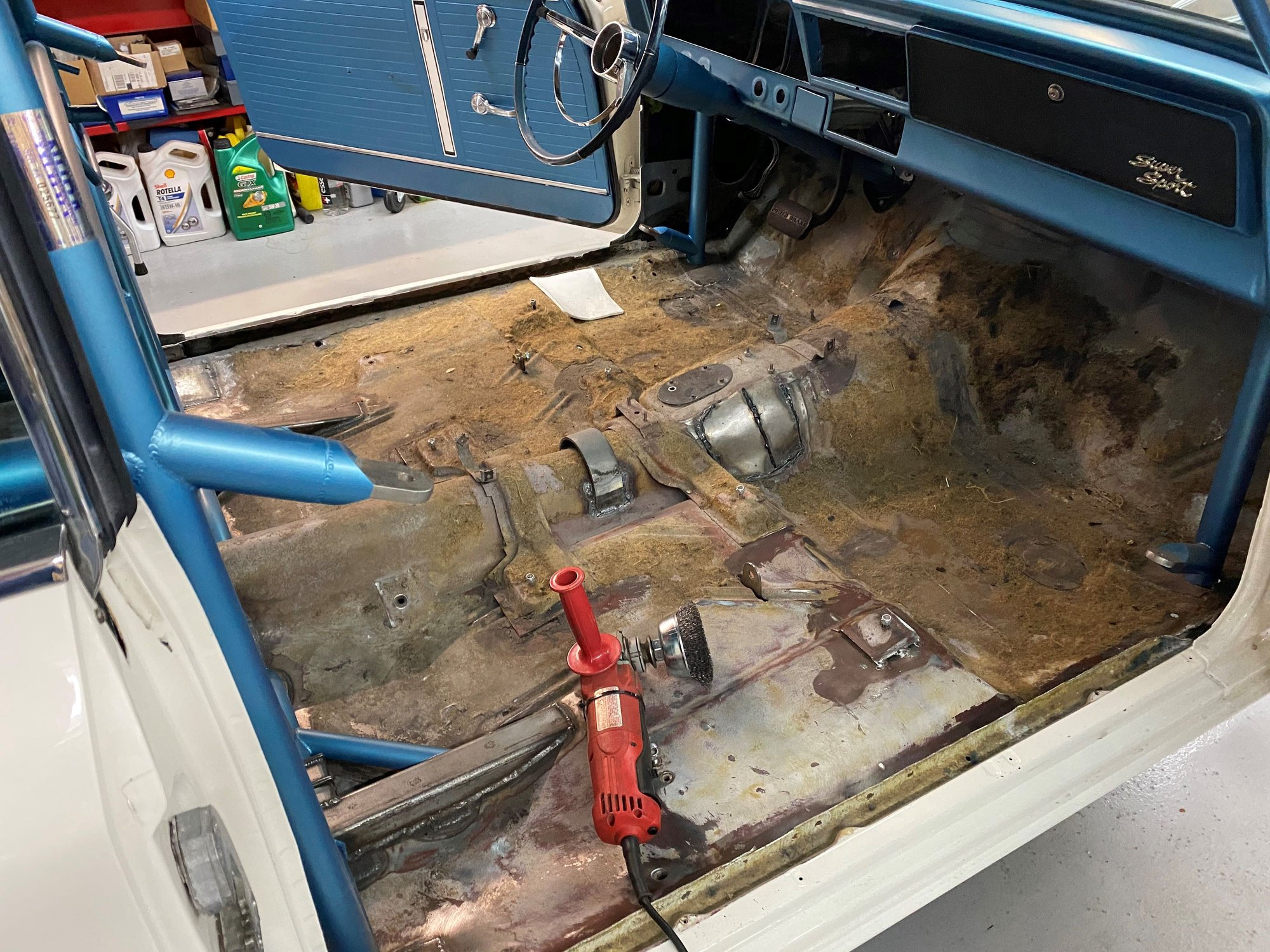

Wanting to start my wiring, but can't live with this floor. It's nice and original with no rust. I plan to ultimately put a full interior in the car, but want it to be clean up until that point, the interior is like your office, you spend alot of time in it.
Although I have the original interior, it will get new carpet for sure. I envision the interior completion will be the last part of this build, and it is possible it may make a trip or two down the 1/4 mile with only a dash, race seat, harness and the essentials.
The last owner glued the carpet backing down and it is a mess to get up, lots of fuzz stuck to the original floor. It goes up in flames very easily as I learned with someone of the welding/fabrication inside along the way.

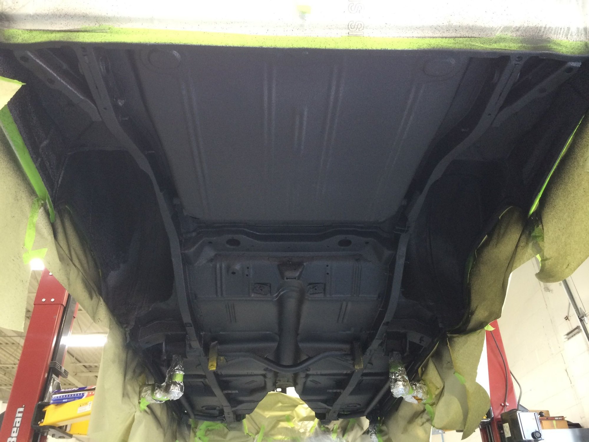

I did the underside using Lizard Skin. I plan to just use a two part black epoxy prime on the inside.

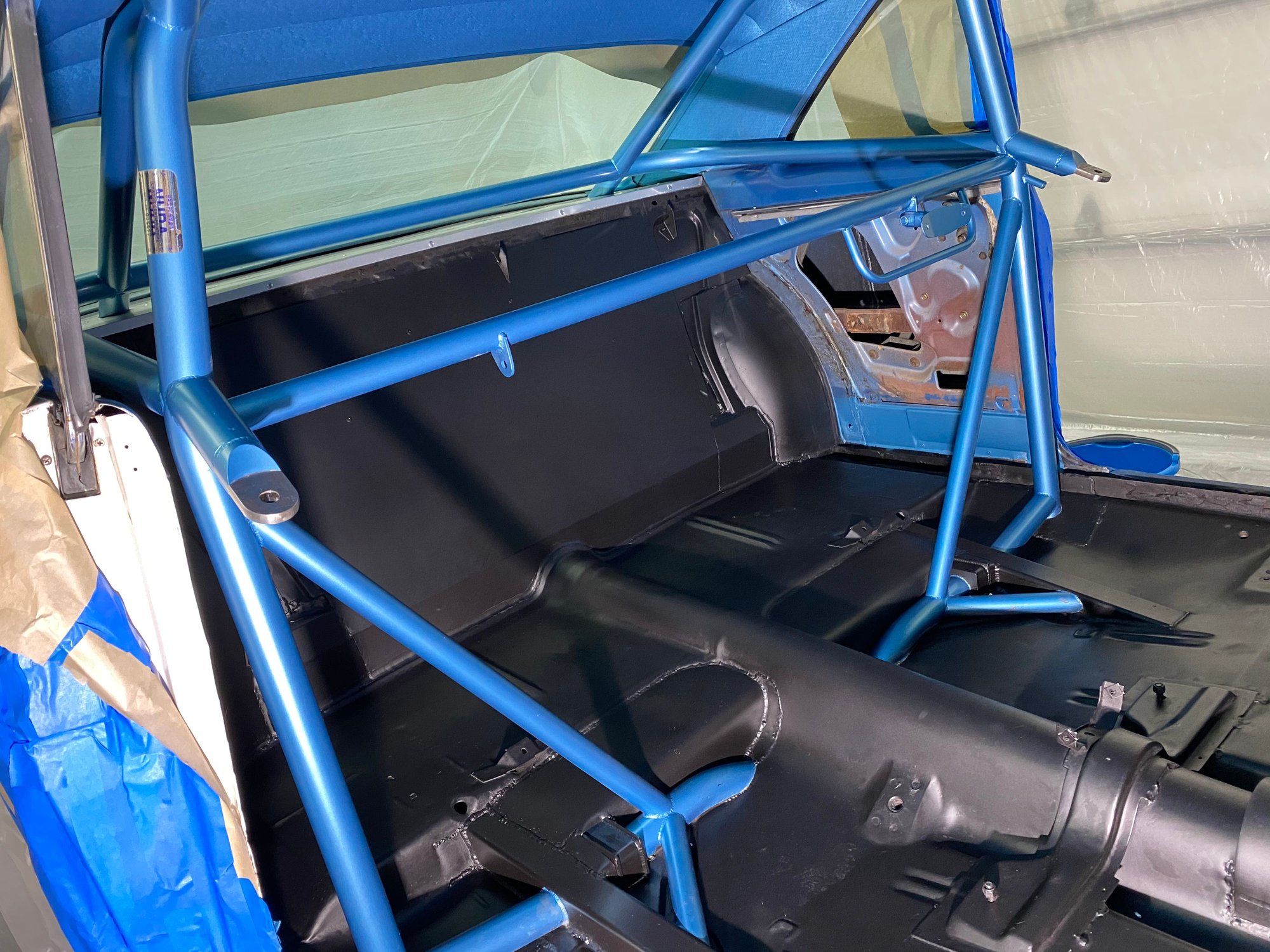

Floor epoxy primed. Ready to start running some circuits and mounting electronics.
