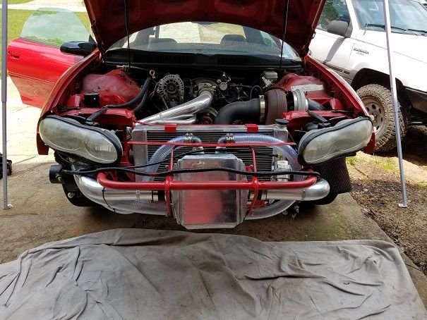

Believe Zack Brown did some nice testing on the efficiency of upgrading from the 3/4 to using true 1" ID fittings. 1" hose on the rule 2000. (standard china A2W core). Went from 10.75 LPM to 16 LPM! @ 13.5 v Looped lines with no core only flowed 18-18.5. So 1" ID fittings alone on the same hose/pump/voltage were worth 5-6lpm more flow. (thats a china meter he was stating GPM in his test, but looks like LPM on the tester?) if its another 5-6gpm that's pretty substantial!
Even the small type 3 frozen boost core seems to outperform the A2A units!
revised 1"
Has the nice pre/post IC gauge.
https://www.youtube.com/watch?v=4MJq6CJsSa8
https://www.norotors.com/index.php?topic=208.1335

That seems like pretty low flow all around, I run the EWP150 pump rated for 150LPM/40GPM and it pulls less amperage than the Rule 2000 pump and very quiet too, but sounds like a jacuzzi with the water blasting the back of the reservoir though. I run the same water pump on my engine cooling system and it runs cooler than with the stock pump so I believe its flow rating.

That meter likely was GPM and not LPM. I haven't gotten to play with any of it personally yet. Just been on various ride alongs and helped with installs.
Is that rated open flow? Even the Rule2000 is rated at 2000 GPH or 33gpm. But system flow with Open 1" lines only flowed 18-18.5 gpm on a meter. Curious what you'd see for actual system flow VS rated. Different class of pumps all together I suppose! Wonder if spending the money on crazy pump like that and running the "budget" core is the way to go. I was thinking the larger cores aren't much more anyway. Grab a standard 2000hp core, cheap pump rule pump, and go. But if you can exchange the water 2-3 times faster the monster pump... All good stuff to think on. I'll have to see how much $ is in the bucket when I get there and decide.
