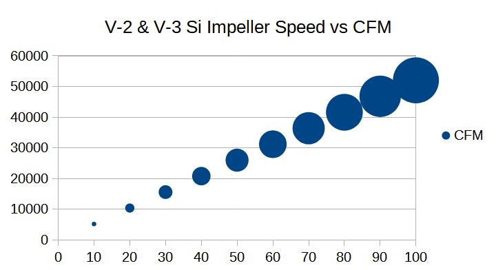

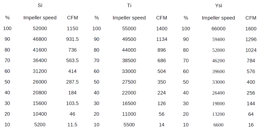

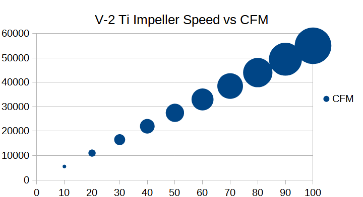

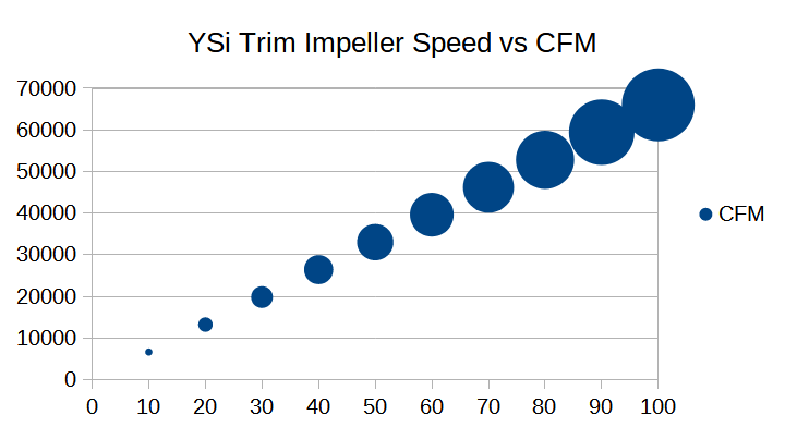

I was surfing the Net and found a formula to calculate CFM of a CSC at various impeller speeds.
I started with the V-2 and V-3 Si trim. Both rated (on the Vortech website) at 1,150 CFM @ 52,000 RPM
I attached a chart and three plots.

The bubble graph didn't seem to show the relationships very well. While I was at it I rescaled the X and Y axes so all of the graphs are to the same scale. That makes a direct comparison easier.
