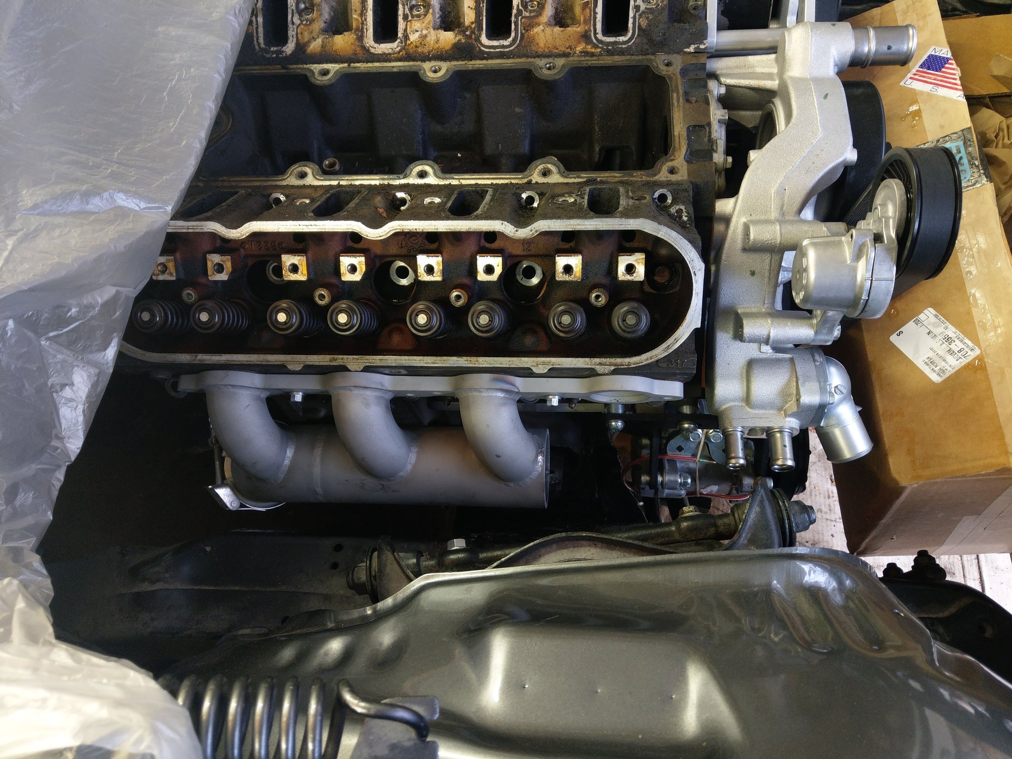

Oh sure, this discussed many times before, I know. What I've read and gathered are either older posts and/or kinda inconclusive. Need fresh inputs to help me to decide. Here's what I have and my goal:
1972 Camaro Pro touring. Test fitted LQ4 and 4L80E and relocated accessories to clear stuff. F body oil pan, corvette water pump. Been working on hot side for a while. Almost finished. Passenger side top mount single turbo. 10.5:1 CR. 317 heads, forged piston/rods with ARP studs, BTR stage 2 cam with matching springs, etc. Wanting 850+ to wheels on E85. %100 street car. want to see some boost by 3000 RPM (Quick spool). Thinking, dual Aeromotive 340 or dual Walbro 450s in tank. Thinking 90# Injectors. Stock ECM. will maintain P/S, A/C.
Now, based on what I've read here, I was leaning toward S475 83/75 T4 1.1AR from forced induction. Then some said S475 is small for a 6.0, go with S480, Then again some said S475 is enough for what you want. Some said VS 7578. Today, I called FI and I've told something totally different. He said S476 96/76 billet 1.32 A/R, advising 1.1 A/R will blow my head gasket resulting in too much back pressure! I'm not opposed to T6 over T4, but I'm not sure if my hood will close and clear T6 housing. He also said we solved that issue by welding a v band instead of flange making it shorter. To what I know, 1.32 A/R with 96 mm turbine won't spool quick even on a 6.0. Not sure. Need some help to figure this out and put it aside. budget is about a grand for turbo. Thank you.

Well. Thank ya'll for all inputs. I've not decided about converter yet. I know I has to be a higher stall range (like 3000-3500 RPM). I'll decide on converter later. Injectors have not ordered yet. Sure, I'm listening. bigger injectors needed. I'm following "Richard Holdener" tests on you tube. He compared S475 with VS 78/75 in one of his tests. S475 was more responsive than VS, VS made slightly more power close to end. also, read S475 or BW in general is more reliable. I'm dealing with very tight space under hood. No off the shelf manifold worked in my case. I put together a 2.5" hot side myself (passenger side) and is not divided. I just need to weld the last elbow under turbo. I'm sure I need something to shows some boost by around 3K and to what I figured that will be a 83, 87 or maybe 92 mm turbine in a 1.1 or 1.25 A/R. Fuel pump I thought dual AEM 340 or 450? not enough?
