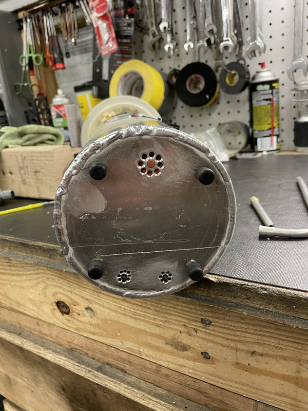

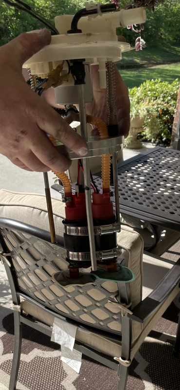

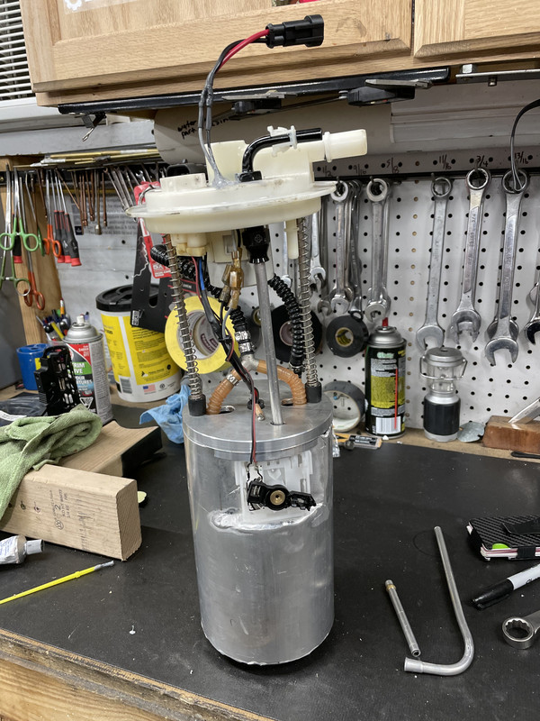

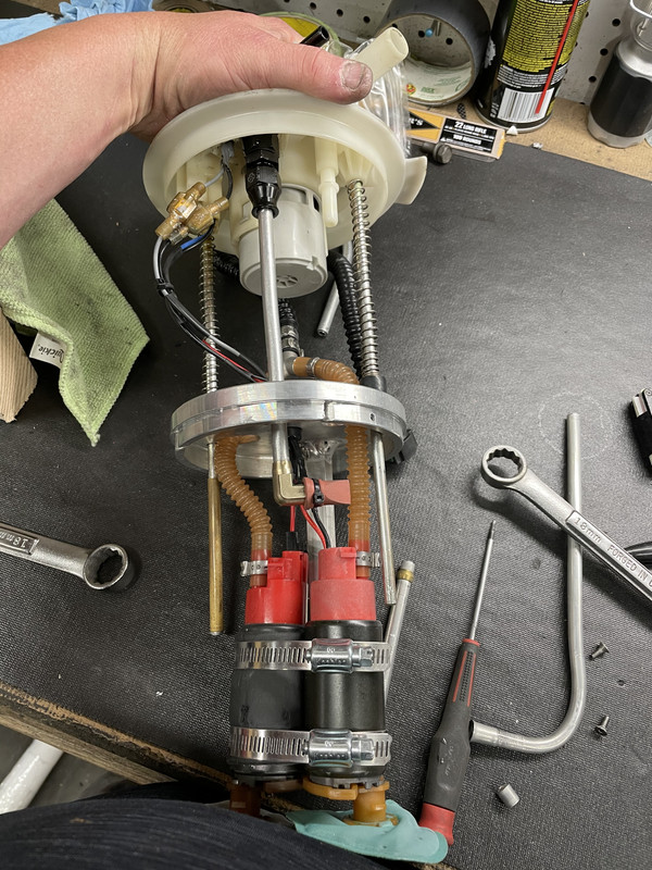

Alright. I’m back at it. Cars been sitting, had to finish the other turbo car and a truck I built an intake for and tuned. Pulled the tank out yesterday. Yep, the return was right at the pumps pickup filters. Probably wasn’t the best idea to do that.
Like dis
So I cut the line shorter and put a 90 degree fitting on it and put a radium engineering one way nozzle (if you disconnect the fuel tank with fuel in it, the return fitting is lower than the tank level and it will constantly siphon fuel out....don’t ask how I found out!)
here’s some pics of the pump bucket I built just for gp
