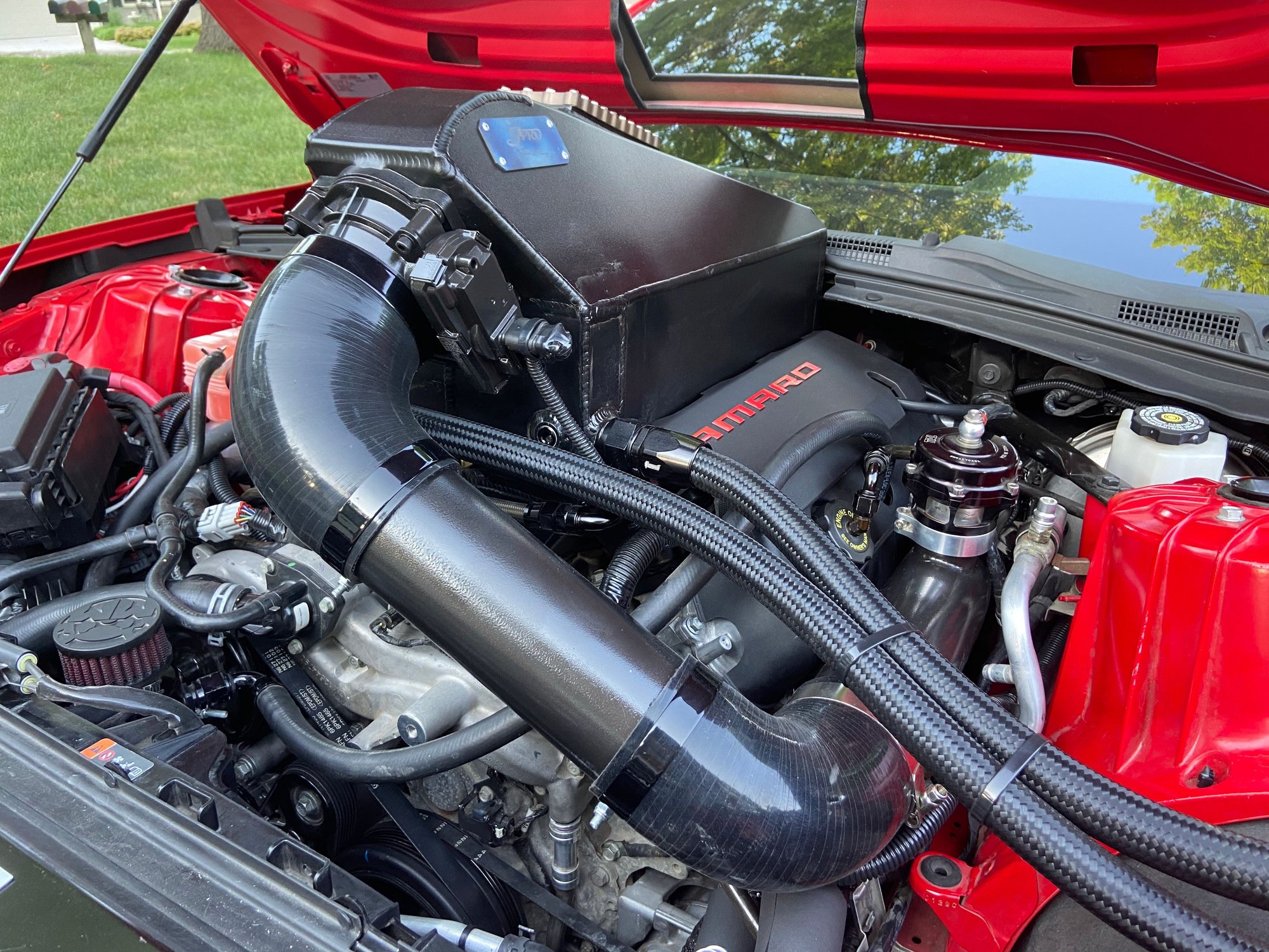

It is port and di. When I said budget I was talking engine not the entire car. It has a monster air/water intercooler with an interchiller kit. Iats are 70deg at the end of a run. 3900 race weight.

Strangest cold side routing I've seen. Rear mount?
Twins in place of stock cats by bellhousing
How is it a single up to the TB on the DS though? Merge somewhere by the trans?
It comes up with a pair of 2” that merge right before the bov.

Thats a wild looking setup you have.
