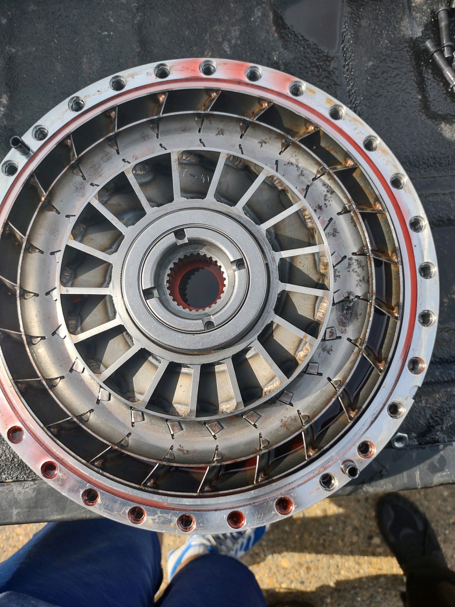

Dyno session was a success.. learned that my converter was a tad tight. Adding dump valves and stator change.

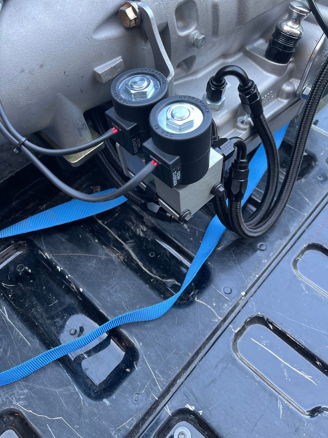

Dump valves added.. should have it back up tomorrow and more testing shortly after.
Is that the Hughes kit ? I’d like to know if the solenoids have any clearance issues.
Old Jul 6, 2021 | 01:36 PM
  #46
ws602's Avatar
Joined: Jul 2002
Posts: 548
Likes: 31
From: shreveport,La
should have feedback soon. I got my BFH READY LOL

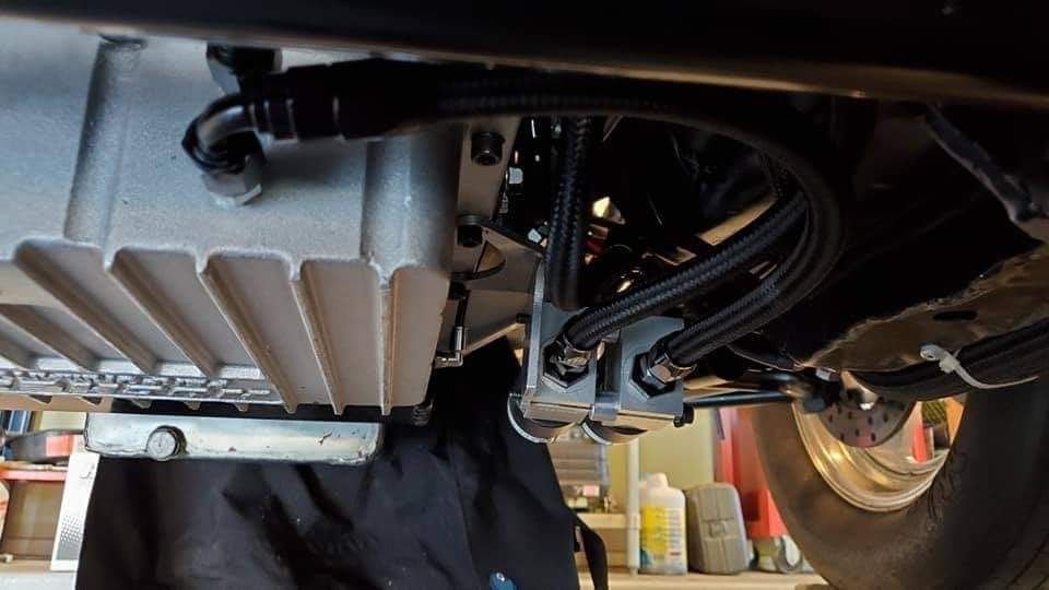

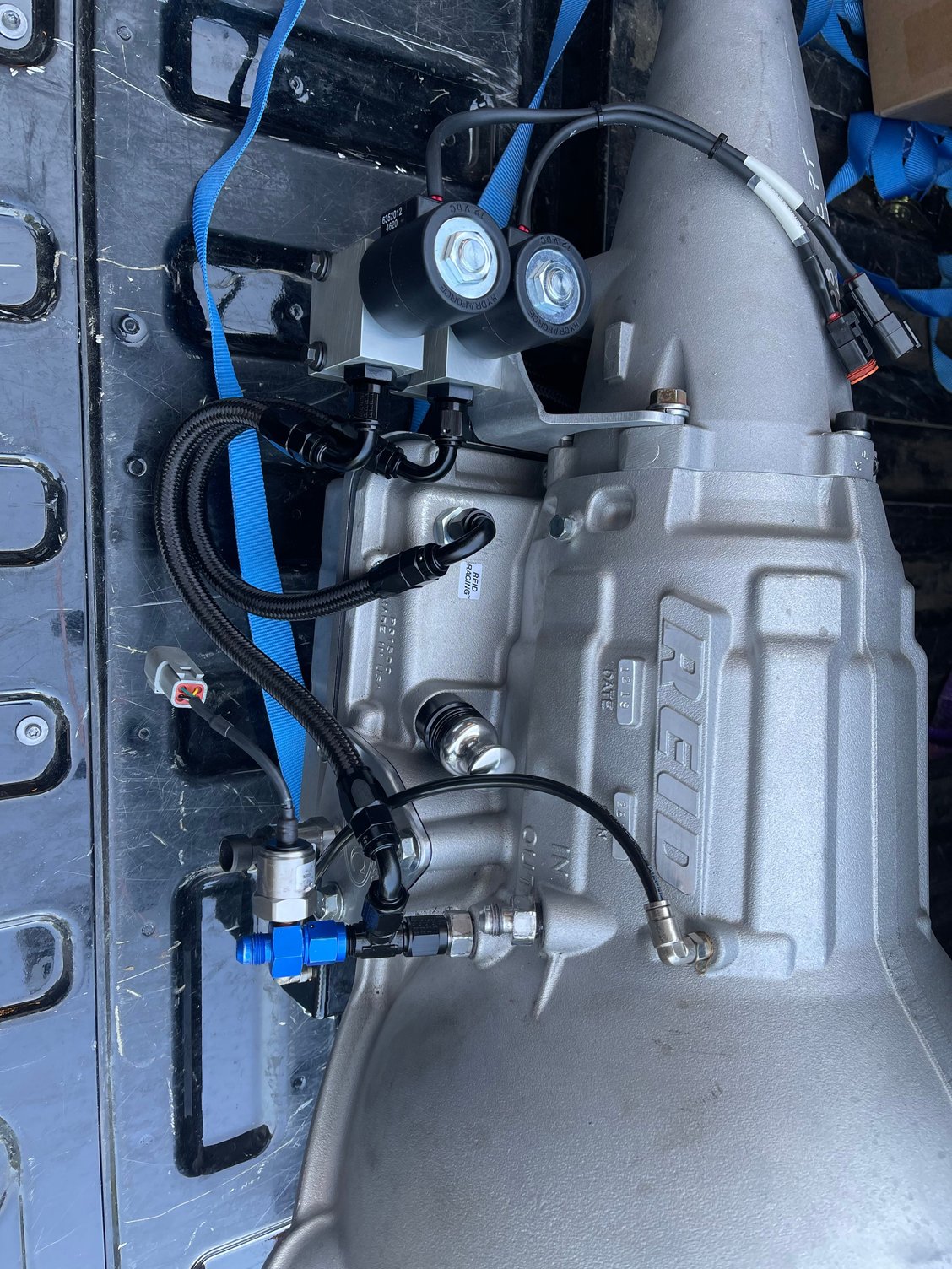

had to mount from the bottom the BFH wasn’t doing the trick put them on the bottom like this.
Old Jul 6, 2021 | 10:19 PM
  #49
gjohnsonws6's Avatar
iTrader: (12)
Joined: Aug 2009
Posts: 1,149
Likes: 168
From: Litchfield Park AZ
I had a feeling that was going to be the case. At least it’s in there. ATF speed recently came out with a combo solenoid/relief combo block that mounts on the side of the tail. It’s only for the cooler port not the internal valve body tap. There’s just no room under there. I had enough trouble making the stand alone regulator and hoses fit.

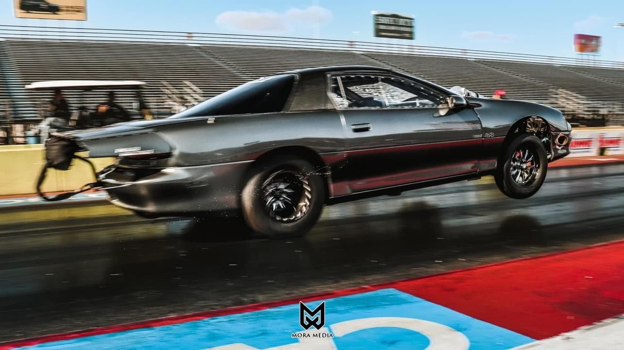

Old Feb 23, 2023 | 08:54 AM
  #51
Black_Sunshine_99's Avatar
Joined: Mar 2013
Posts: 3,858
Likes: 840
From: Washington
How did you sort out the rear wing which looks great btw.
I know there are a couple different people who make the wing but if you have a stock SS spoiler on the hatch lid they won't work.
Did you buy another hatch or were you able to find just a Z/28 or base model spoiler?

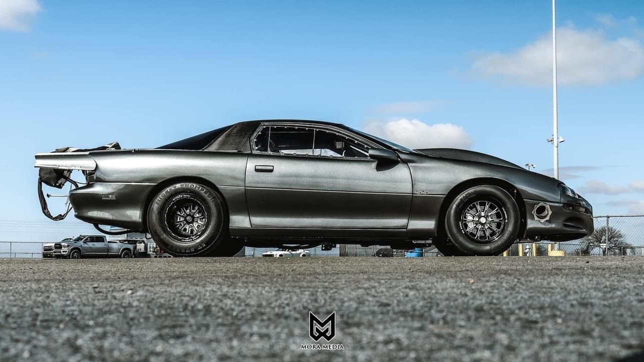

Finally getting to make some good passes
